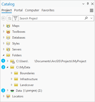

Folder connections in the Catalog pane
In this example, folder connections display complete path names.
Icon Description
1 A connection to the project home folder (created by default)
2 A connection to a folder on a local drive
3 A connection to a folder on a network drive
