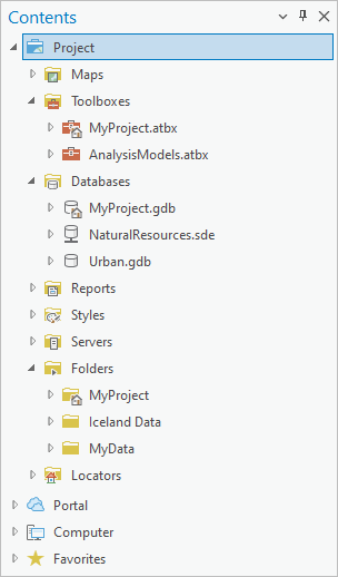

Item connections in the Contents pane of a catalog view
Connections to toolboxes, databases, and folders are displayed in the Contents pane of a catalog view.
