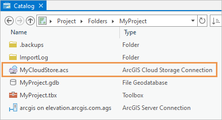

Connections to cloud stores are stored on the file system as files with the .acs extension.
A cloud storage connection in a catalog view
By default, cloud storage connection files are saved to the project home folder.
