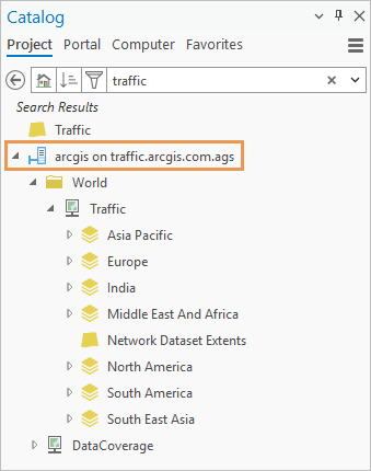

Catalog pane showing search results that include a server connection
A search on the term traffic returns a server connection because the connection file name includes the search term. You can then browse the server contents.

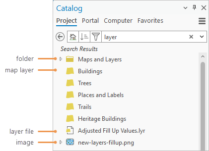

Catalog pane showing search results with various items
A search on the term layer returns items with file names that include the search term and items that match the file type.
