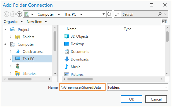

Create a template to use on multiple computers
If you create projects on multiple computers, it's recommended that you store the project template in your portal so that it is accessible from any machine. The template should only include connections that are accessible to all the computers you intend to use it on.
By default, when you add a connection to a project, the connection references the letter the drive is mapped to, such as C:\MyData or X:\Boundaries.gdb. This means that when you create a project from the template on a different computer, the connection will be broken if the referenced location is mapped with a different letter. For this reason, if you plan to save a project as a template, it's recommended that you add network folder connections as UNC paths: \\<computer name>\<folder>.
A folder connection added with a UNC path
Datasets that are sources for map layers are copied to the template if they are stored on local drives. Datasets that are stored on network drives or enterprise geodatabases are referenced, not copied. This has implications for data editing. When data is copied to the template, every project created from the template has a new local copy of the data, and edits are performed on the local copy. When data is referenced, every project created from the template references the same dataset, and edits made in any project are performed on that dataset.
