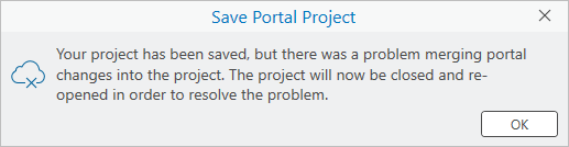

Resolve an unsuccessful merge of portal updates
After your changes to the local copy of the project are saved to the portal, portal updates by your collaborators may be downloaded but not merged with your local copy of the project. In this case, the following message appears:
Message that the project will be closed and reopened to resolve a merge problem
A problem with merging updates means that the local copy of the project is in an unstable state. It must be deleted from its location on your computer and downloaded from the portal again.
To resolve the problem, click OK on the Save Portal Project message.
ArcGIS Pro closes the project, deletes the local copy from your computer, and re-creates the project in the same folder. Your local copy of the project is identical to the portal project, and you can continue to work.

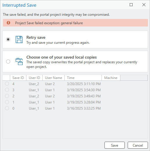

Resolve an unsuccessful upload to the portal
After your local copy of the project is saved, your changes may not upload successfully to the portal. If this occurs, the Interrupted Save dialog box appears. The project may be in an unstable state on the portal. You can either retry the save or overwrite the portal project with one of your saved local copies.
Interrupted Save dialog box with Retry save option selected
Machine names were removed from the image.
Retry save
The default option is to retry the save. If the upload failure occurred before your changes were merged into the portal project, and if the cause of the problem—for example, a power failure—is resolved, this operation typically succeeds.
To retry the save, complete the following steps:
  1. Confirm that the Retry save option is selected on the Interrupted Save dialog box.
  2. Click Save.
    If the save is successful, you can continue working. If the save fails again, the Interrupted Save dialog box reappears. In this case, the portal project is in an unstable state and must be overwritten.

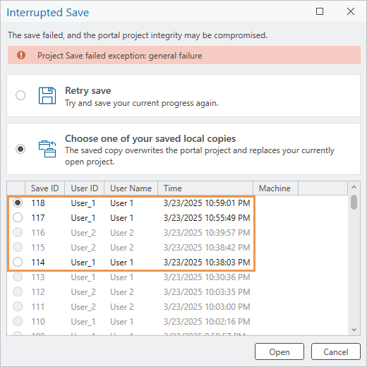

Overwrite the portal project with a saved local copy
You can overwrite the portal project with any of the three most recently saved states of your local copy of the project. These saved states are stored as independent project files (<project name>.aprx) in your user profile at C:\Users\<username>\AppData\Local\ESRI\ArcGISPro\PublishedProjects. They are saved in a folder with the same name as the folder that contains the current local copy in the download location. Each of your collaborators also has their three most recent saved states of the project.
You can change the number of automatically saved copies of the project, and their location, in the options for creating projects on an ArcGIS Enterprise portal. These settings can also be made by your organization administrator in the application settings for portal projects.
To overwrite the portal project with one of your saved local copies, complete the following steps:
  1. On the Interrupted Save dialog box, click the Choose one of your saved local copies option.
    The lower part of the dialog box shows the save history of the project. Your three most recent saved states of the project are available. Earlier saves are visible but are not available.
  2. Click one of the available saved local copies to select it.
    Interrupted Save dialog box with the option to use a saved local copy selected
    User 1 selects their most recent successful save. Machine names were removed from the image.
  3. Click Open.
    You are prompted to confirm your decision.
    Message regarding confirmation of the overwrite operation
  4. Click Yes on the Overwrite Portal Project message.
    The portal project is overwritten with the saved local copy of the project that corresponds to the selected option. This copy also replaces your currently open local copy of the project. Unsaved changes in the open project are lost. The portal project and your local copy of the project are now in an identical state and you can continue to work.
    Note:
    If you click Cancel on the Interrupted Save dialog box, a message that the project was not saved appears. Similarly, if you click No on the Overwrite Portal Project prompt, no action is taken. Your copy of the local project remains open, and the portal project remains in a potentially compromised state.
Contact a collaborator to overwrite the project
One of your collaborators may have a saved copy of the project that is more recent than yours. In this case, a yellow banner warning appears at the bottom of the Interrupted Save dialog box.
Interrupted Save dialog box with a yellow warning banner
The dialog box displays a warning that the current user did not make the most recent save. Machine names were removed from the image.
In the image above, the saves available to User 1 (Save IDs 118, 117, and 114) are not as recent as the last save made by User 2 (Save ID 119). User 1 does not have access to User 2’s saved copies. Before overwriting the project, User 1 should contact User 2 and discuss how to proceed.
