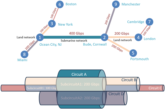

Circuit
A circuit is a collection of components that represent a dedicated path between specified elements in a telecom domain network. A circuit can be physical or virtual, and be composed of disconnected collections of connected elements, which are called sections. A circuit can be composed without sections, or by one or more sections that are partially ordered (arranged in parallel or sequentially). Circuits can also be divided into subcircuits to share capacity or bandwidth.

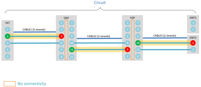

Circuit location
Circuit locations correspond to active, signal emitting ports (i.e. transceivers) in the network which define the start and stop location of a circuit. Circuit locations are defined in the network through the assignment of the Circuit Location network category.

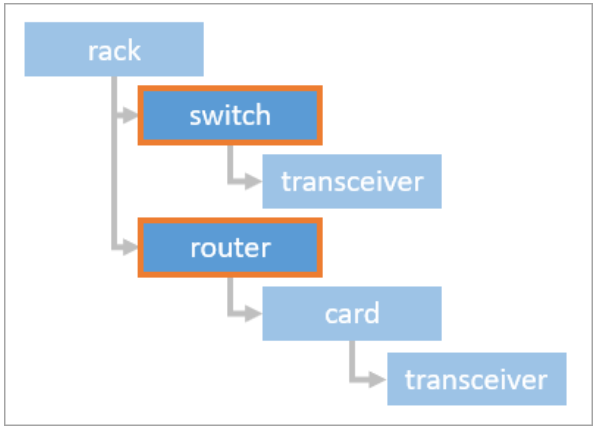

Conflict container
Conflict container is a designation given to container features in a telecom domain network to indicate the top (or root) of a specific containment hierarchy which are assigned the Conflict Container network category. You define the containers that will act as conflict containers in the schema by determining which unit or group of features will be treated as a group during reconcile if conflicts are detected.
For example, the diagram below illustrates the containment hierarchy for a rack. In this example, if you specify switch and router as local roots for each branch (or subtree) of the containment hierarchy using the Conflict Container category (orange outline), when it's reconciled, if conflicts were created, they will be returned as separate conflict sets under each conflict container for review.
Containment hierarchy for a rack using a conflict container

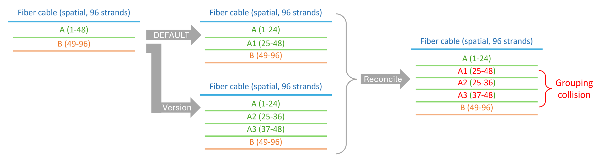

The existence of large containment hierarchies may require that multiple conflict containers be defined to limit the conflicts that are rolled up to each conflict container for evaluation. In the example above, you could have specified the rack as the conflict container; however, in that scenario, logical conflicts from all branches in the containment hierarchy would be rolled up and displayed through the rack feature, which may be more challenging to review.
During reconcile operations, features that are assigned this category are used to report logical conflicts to the user in a conflict set. A logical conflict will not be identified and reported using traditional conflict detection. To understand this, consider the example below which illustrates grouped fibers inside of a cable. In this scenario, the fibers inside the cable are divided using different approaches in the default version and a named version. The divided fibers are created as inserts in new rows that would not traditionally lead to the detection of conflicts; however, through the use of the Conflict Category assignment when reconciled, these edits would conflict logically at the container level to return a conflict set on the conflict container feature. In this example, the fiber cable has been defined as the conflict container and the grouping of fibers for Fiber A is modified in the default version and in a named version:
Fiber cable with grouped objects in conflict
In Default, Fiber A1 is created for strands 25-48, and in the version, Fiber A2 and Fiber A3 are created to represent fibers 25-36 and 37-48, respectively. In both examples, Fiber A is modified in the same way, and the divided fibers are created as inserts in new rows. When reconcile occurs, a logical conflict is detected at the container level and reported as a conflict set under the Fiber cable for review.

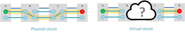

Connectivity inference
Connectivity inference refers to the process used in scenarios where physical connectivity is not present between a specified start and stop location in a telecom domain network and must be inferred by traversing a feature's containment hierarchy to identify a path in a path trace.
The Edge Unit Container, Junction Unit Container and Unit Identifiable network categories can be assigned to applicable container and content asset types, respectively, to support connectivity inference through a feature's containment hierarchy where physical connectivity is not represented.
When a path cannot be found using explicit feature connectivity, connectivity inference can be enabled using the Infer Connectivity parameter on the Trace and Add Trace Configuration tools. When a path trace encounters unit identifiable junction objects with one connected edge and the Infer Connectivity option is enabled, the feature's containment hierarchy is traversed to find a container assigned a unit container category. A downward traversal then occurs to find other unit identifiable junction objects which become candidates for traversal to find a path to the stop location.
The below example illustrates how connectivity inference is used to discover a path between Port 3 on the Optical Line Terminal (OLT) and Port 3 on the Optical Network Terminal (ONT). Because no explicit connectivity is modeled between the ports on the Fiber Distribution Panel (FDP), the ports are assigned the Unit Identifiable category and the FDP is assigned the Junction Unit Container category. When the path trace is run with the Infer Connectivity option checked, any ports in the FDP with a valence of 1 are evaluated to determine whether a path can be found to the specified stop location.
Note:
Unit identifiable junction objects with no connected edges are evaluated when they are set as the stop location in a path trace.
Example of connectivity inference being used to discover a path

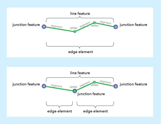

Edge elements
The utility network comprises a logical network of junction and edge elements. Edge elements compose the logical component of edge (or line) features in a utility network. A complex edge feature is associated with a set of edge elements in the network topology.
As an example, a water main represented by a single line feature may be composed of multiple edge elements separated by taps for service lines. In the example below, the addition of a junction with midspan connectivity creates a single line (or edge) feature comprised of multiple edge elements.
The presence of junctions with midspan connectivity along a line (or edge) feature creates a feature composed of multiple edge elements.

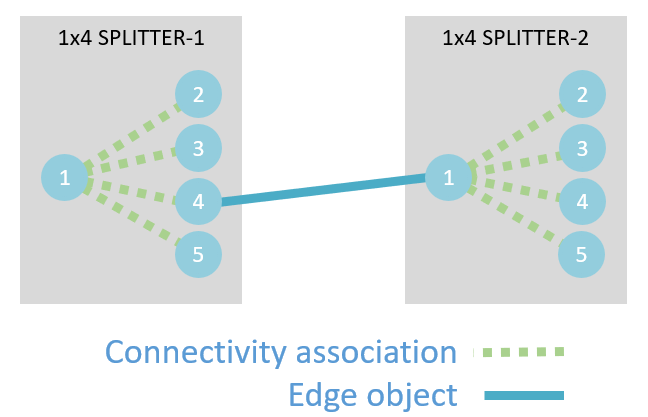

Edge object
Edge objects are nonspatial network features used to model and work with a large number of real-world features that share a common geographical space. Objects in this table represent linear operational or structural features that are often contained in other objects. Examples include individual ducts in a conduit system or patch cords in a fiber enclosure. This allows organizations to model their network in more detail without the need to create features with geometry for every asset.
Learn more about junction and edge objects.

Section
A section is a logical collection of elements in a circuit that can be identified through a single trace operation. Sections are defined by one start location and stop location. Sections are modeled using the CircuitSection table.
The example below illustrates a circuit composed of three sections. There is no internal connectivity in the ODF and FDP equipment.
Diagram of a circuit composed of three sections

Splitter
In a telecom domain network, a splitter is a passive device which splits a signal to multiple outputs which are isolated from one another.
Modeling splitters with their fanout can create performance challenges during tracing and analysis operations in the utility network. To address this, the splitter network category can be assigned to specific asset types which define splitters in a telecom domain network. The category prevents multiple paths from being found when a splitter is encountered and optimizes the process of marking circuits as dirty when validating the network topology.
When modeling splitters in a telecom domain network, the following are considered best practices:
  • Create a specific asset type in the junction object class for splitter ports and assign it the splitter network category.
  • Use junction-junction connectivity associations to model connectivity between the splitter ports (junction objects) inside of a splitter device.
  • Use edge objects (contained within a line) to model connectivity between devices that contain junction objects assigned the splitter network category (for example, an output port on splitter 1 to an input port on splitter 2).
    Example diagram showing connectivity within and between splitter devices in a telecom domain network.

Subcircuit
A subcircuit is a portion of a circuit that can be used to define another circuit. For example, when a portion of the capacity or bandwidth of a circuit needs to be shared, the circuit must be divided into subcircuits. A consumer circuit uses a subcircuit to define a circuit section whereas the circuit from which a subcircuit originates is referred to as the provider circuit. Subcircuits are connected in parallel, not in a series.
The example below illustrates a subcircuit. Circuit A is defined on the submarine network between nodes 1 and 2 (Ocean City, NJ and Bude, Cornwall, respectively), with a capacity of 400 Gbps. The capacity of the provider circuit (Circuit A) is divided into two subcircuits, SubcircuitA1 and SubcircuitA2 with 200 Gbps each that can be consumed by other circuits to enable resource sharing. The consumer circuit (Circuit B) then consumes SubcircuitA1 from Circuit A. Circuit B can also be further divided into subcircuits as shown by SubcircuitB1 consumed by Circuit C.
Example of a circuit's capacity divided into subcircuits for consumption by other circuits

System junction
A system junction is a hidden network feature that is placed at the endpoint of a network edge element when there is no user-defined junction. System junctions are generated during the initial enabling of the network topology or through validating the network topology. These features are hidden in the map view, but you can display them in a network diagram view.
There are a few situations in which system junctions are created:
  • A single edge element with no user-defined junctions at the endpoints
  • Two edge elements that share an endpoint and do not have a user-defined junction connecting them
    • If the edge features have the same Asset group and Asset Type attributes, a system junction is created between the edge features and connectivity is established.
    • If the edge features have different Asset group and Asset Type attributes, a system junction is created at the end of each edge feature, and connectivity is not established. Errors are created.

Virtual circuit
A virtual circuit is a logically established communication pathway that simulates a dedicated physical connection in a physical network infrastructure. This type of circuit is commonly defined between a starting and stopping point in cases where the composition and traversability of the underlying physical network is unknown. Virtual circuits are not represented in the network topology but are instead modeled within the circuit management tables.
An example comparing a physical (left) and virtual circuit (right).
The Circuit type and Section type fields in the circuit management tables are used to model whether a circuit is physical or virtual. A circuit is considered virtual when it contains one or more virtual sections. The simple circuit examples above are defined between A port 1 and D port 1 and consist of three sections. In the physical circuit on the left, all three sections are physical and the circuit would be defined as a physical circuit. The virtual circuit on the right consists of two physical sections, with a virtual section modeling connectivity between B and C, although the path is unknown.
