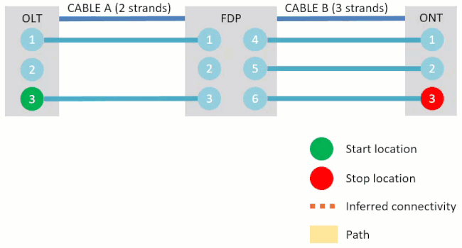

Infer Connectivity
When performing a path trace in a telecom domain network, there may be scenarios in which explicit connectivity between a provided start and stop location does not exist. The Infer Connectivity parameter can be used in situations such as this to find paths and model circuits using connectivity inference when connectivity information is missing.
Some organizations may prefer not to physically model every feature in their network, such as the patch cables connecting ports in a patch panel. In these cases, it is understood that connectivity exists and must be inferred, even if not modeled explicitly. The Unit Container and Unit Identifiable network categories can be assigned to asset types to support connectivity inference through a feature's containment hierarchy where physical connectivity is not represented.
In the below example, connectivity inference is used to discover a path between Port 3 on the Optical Line Terminal (OLT) and Port 3 on the Optical Network Terminal (ONT). Because no explicit connectivity is modeled between the ports on the Fiber Distribution Panel (FDP), the ports are assigned the Unit Identifiable category and the FDP is assigned the Unit Container category. When the path trace is run with the Infer Connectivity option checked, any ports within the FDP with a valence of 1 are evaluated to determine if a path can be found to the specified stop location.
Note:
Unit identifiable junction objects with no connected edges are evaluated when they are set as the stopping point in a path trace.
Example of connectivity inference being used to discover a path
Configuration option
Description
Infer Connectivity
  • Checked—The path trace will use connectivity inference to traverse containment associations and identify a path between the specified start and stop location when incomplete connectivity prevents traversal.
  • Unchecked—Connectivity inference is not used to identify a path between the specified start and stop location. This is the default.

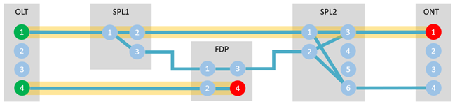

Num Paths and Max Hops
When performing a path or circuit trace, there are two parameters which limit the number of paths traversed and help to define how valid paths are identified and returned.
The Num Paths parameter specifies the maximum number of paths that will returned between a given start and stop location. The total number of paths returned equals the number of start locations x the number of stop locations x the Num Paths value. For example, if you have a single start location and three stop locations and set Num Paths to 2, 6 distinct paths are returned. When the number of discovered paths exceeds the specified number of paths to return, priority is given to the paths with the fewest hops. The Num Paths parameter is configurable as part of the trace configuration using the Trace tool. The default is 1.
When a path trace is configured using the Shortest Path Network Attribute Name parameter and the default Num Paths parameter value of 1, the shortest path can be returned. See Return the shortest path for more details.
The Max Hops parameter specifies maximum number of hops between edges allowed in a path, excluding the starting point. During a trace all edges and junction-junction connectivity associations are evaluated as having a fixed unit length of 1 on traversal while terminal devices are evaluated as having a fixed unit length of 2. The Max Hops parameters can be configured in the Trace tool, or as part of the circuit properties when working with a telecom domain network. The default is 100.
The diagram below illustrates an example path trace between starting points in the OLT and stopping points in the FDP and ONT. In this example, Num Paths is 3 and Max Hops is 5. Valid paths are returned between OLT1 and ONT1 as well as OLT4 and FDP4. An additional path between OLT1 and ONT1 through FDP1 and FDP 3 is not returned because this would require 7 hops between the starting and stopping points to define the path.
Example path trace result where Num Paths is 3 and Max Hops is 5.
These parameters are honored only when the trace type is Path or Circuit.
