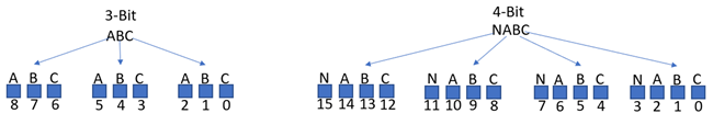

To properly calculate substitution values and configure attribute substitution, you need to think in terms of all 3 bits as each having 3 bits underneath them to describe the substitution for what bit A, B, and C are to become. With the 3-bit system, there are 9 bits to deal with. In a 4-bit system, adding a neutral to A, B, and C, there would be 16.
Illustration of 3 and 4-bit systems for substitution.

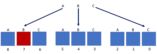

Focusing on a 3-bit system example from the Electric Utility Network Foundation solution in which A becomes B, B becomes de-energized, and C becomes de-energized (ABC->B00), we can better understand how this substitution is made. The A bit would switch to the B bit in that first position and the substitution bit would be 7. To substitute de-energized for Phase B or C does not require you to provide any value. To make this substitution, the value of 128 would be used, which is 2^7.
Example substitution where Phase A becomes Phase B.
From A
From B
From C
To A
256 (2^8)
32 (2^5)
4 (2^2)
To B
128 (2^7)
16 (2^4)
2 (2^1)
To C
64 (2^6)
8 (2^3)
1 (2^0)

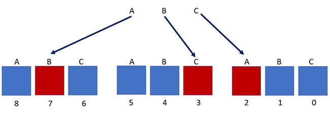

Alternatively, if you wanted to substitute Phase B for Phase A; C for B; and A for C (ABC->BCA), the result would look like the following image where A becomes B, B becomes C, and C becomes A. To make this substitution, the value of 140 would be used, which is 2^7 + 2^3 + 2^2 (128 + 8 + 4 = 140).
Example substitution where Phase A becomes B, B becomes C, and C becomes A.
From A
From B
From C
To A
256 (2^8)
32 (2^5)
4 (2^2)
To B
128 (2^7)
16 (2^4)
2 (2^1)
To C
64 (2^6)
8 (2^3)
1 (2^0)

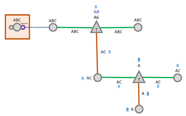

To understand how the substitution values work with the propagated value, consider the image below displaying phase on an electrical circuit. The propagated value is ABC coming from the source controller feature on the left side. The triangle feature marked with a T represents a tap; that is, its asset type is tagged with the system-provided category of Subnetwork Tap. When an analytic operation encounters the tap, an attribute substitution takes place using the substitution value if one is set. For example, using the value of 128 for 3 bits indicates the following:
  • A becomes B.
  • B becomes de-energized.
  • C becomes de-energized.
The next connected feature's propagated value is the result of the calculated substitution value on the tap. In the example below, the tap has a network attribute value of AC, which is recalculated to B. Each subsequent feature with an A in its set of phases is replaced with a B while the analytic operation takes place.
Phase swap using taps in an electrical circuit.
In the image above, black label values represent network attributes (Phase), the purple label values represent the substitution network attribute, and the blue represents the propagated network attribute value. Notice the features connected to the right of the first tap do not display a propagated value of B. This is because the tap feature has the subnetwork tap network category assigned, which allows the tap's substitution value to only affect those features connected off the main line, the line on which the tap is midspan.
Note:
Network features marked with the subnetwork tap category must be midspan on a line, otherwise they will become errors when validating the network topology.
The features connected to the right of the second tap have the same value propagated down through the first tap (denoted by the blue B). The features connected below the second tap have underlined Bs to denote new propagated values calculated from the second tap.

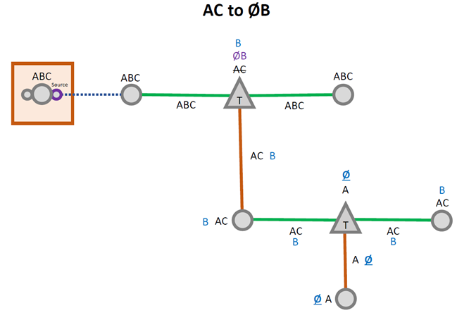

Substitutions allow you to further refine the results of propagated values. Consider the example above with that below. In the example above, the second downstream tap is energized, where the substitution is: A becomes B, and B and C become de-energized. In the example below, where the substitution is: A becomes de-energized, C becomes B, and B becomes de-energized; the second downstream tap is de-energized, (substitution value of 2 on the right side instead of 128 in the example on the left) effectively de-energizing the tap and any features tapped off from it.
Phase swap using taps and slight variation of substitutions: AC to ØB.

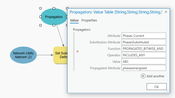

Propagated values, including attribute substitutions, are not used to override the values on your features or the associated network attribute values. When you export a subnetwork, propagated values are stored in the extracted information. When a subnetwork is updated, propagated values can be stored in the Propagated Attribute field, if defined. This field is set using the Set Subnetwork Definition tool when configuring a tier. This example shows a tier with Propagators configured that include a Substitution Attribute as well as Propagated Attribute, both of which are optional.
Example model displaying Propagators configured with a Substitution Attribute.
Using the Propagator configured in the image above, when a subnetwork in this tier is updated, the Phases Current network attribute, defined as the Attribute field in the image, will be propagated. If it traverses a feature with the subnetwork category of Attribute Substitution, it will check for a substitution value using the PhasesSubstituted network attribute defined in the Substitution Attribute field. The resulting propagated value, including substitution if applicable, will be written to the phaseenergized field, which is defined in the Propagated Attribute field.
