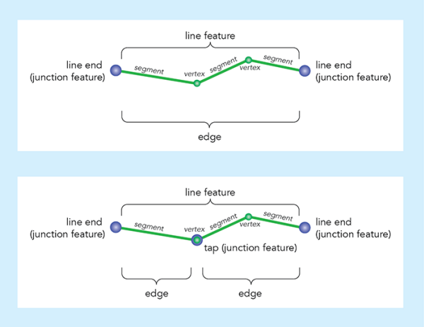

Apportionable network attributes
Apportionable network attributes are configured with the apportionable property set to True. You can assign network attributes with the apportionable property to fields in the line, polygon, and junction feature classes as well as to junction and edge object tables, but only line features and edge objects will display apportioned behavior.
For apportionable network attributes, analytic results are more precise because apportionable values such as line length, impedance, and other flow characteristics are computed for more accurate locations of tap features on a line. This means that trace analytics using apportionable network attributes with a function (Add, Average, Count, Max, Min, and Subtract) will return apportionable results based on edge elements of the network features.
The image below provides two examples:
  • The top image shows a connected line feature with a single edge. The example has one line feature and two junction features. Two line end junction features are spatially coincident with the end vertices of the line. This is the simple case of a connected line feature in a utility network.
  • The bottom image shows a connected line with two edges. The example has one line feature and three junction features. A tap junction feature is added and snapped to a vertex. This logically divides the line feature into subparts that are called edges. An edge is a set of one or more line segments between two junction features that are connected to a line feature. When doing analysis on apportionable network attributes, edges are collected to more precisely define the scope of analysis.
