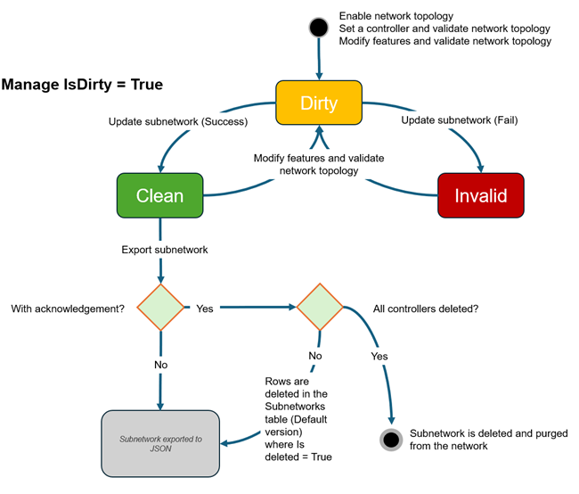

The following diagram illustrates the life cycle of a subnetwork in a tier that is configured to manage Status on the Subnetworks table:
Diagram displaying the life cycle of a subnetwork in a tier that is configured to manage Status on the Subnetworks table.

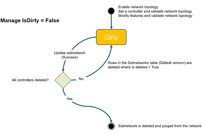

When a tier's Update subnetwork policy is not configured to manage the Status attribute, the subnetwork life cycle is simplified. In this scenario, subnetworks always display as Dirty whether an update subnetwork operation succeeds or fails. The following diagram illustrates the life cycle of a subnetwork in a tier not configured to manage Status on the Subnetworks table:
Diagram displaying the life cycle of a subnetwork in a tier that is not configured to manage Status on the Subnetworks table.

A subnetwork can be clean, dirty, or invalid. This is tracked by the Status (Is dirty) field in the Subnetworks table and applies to all subnetwork controllers for a subnetwork when updated. The subnetwork statuses are defined as follows:
  • Dirty—A dirty subnetwork is a subnetwork that contains validated edits that have not yet been processed by the update subnetwork operation. Validating the network topology discovers and marks controllers of a subnetwork as dirty when the geometry or network attributes for a network feature in that subnetwork have been modified. All controllers in the Subnetworks table for a dirty subnetwork have their Status set to Dirty.
  • Invalid—An invalid subnetwork is a subnetwork in which validate consistency failures or subnetwork errors are discovered during the update subnetwork operation. These issues and errors must be addressed by modifying the geometry or network attribute for the impacted network features and validating to update the subnetwork status, changing it to Dirty. Invalid subnetworks are ignored during the update subnetwork operation and must first be made dirty before they can be updated again and marked as Clean. All controllers in the Subnetworks table for an invalid subnetwork have their Status set to Invalid.

  • Clean—A clean (or consistent) subnetwork is a subnetwork that has been successfully updated. All controllers in the Subnetworks table, the record in the SubnetLine feature class, subnetwork system diagrams, and various fields for modified network features have been updated and are in sync with changes made to the network topology. All controllers in the Subnetworks table for a clean subnetwork have their Status set to Clean.
