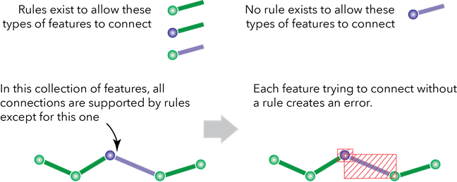

In the example below, a point feature has been placed geometrically coincident to a line feature. There is no rule to allow the two asset types to connect. When the network topology is validated or enabled, errors are generated. In this example, since no rule exists, an error is created for the point and line feature. In addition, the network features are not connected in the network topology.
Points and lines with errors

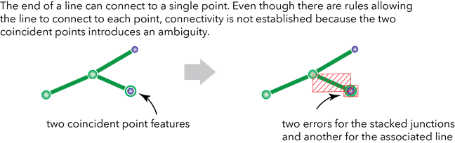

Another example of a situation that violates restrictions of a utility network is coincident features that create ambiguity with regard to connectivity. These are cases in which there are three or more coincident features, and connectivity rules allow any of them to be connected. For example, a dead end and a riser are located at the same endpoint on a medium-voltage line. There are two connectivity rules: one to allow the medium-voltage line to connect to the dead end and one for the line to connect to the riser. Since there are two possibilities, the utility network tracks this as an error. The utility network will not exhibit random behavior in terms of which feature is connected to which other feature. It will, however, tell you where you need to make that decision by flagging the features with errors.
In the example below, there are two types of network point features (riser and dead end) that do not allow geometric coincidence. Two additional errors will be created to track this violation for the point features.
Ambiguous line-to-point connectivity
