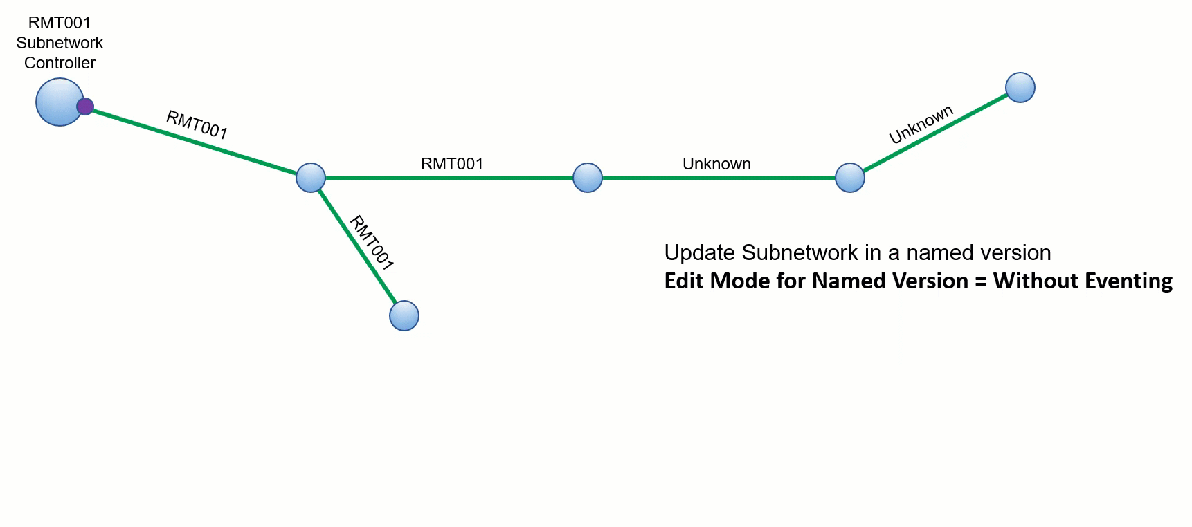

    The example below illustrates the impact of updating a subnetwork in a named version on the RMT001 subnetwork following the creation of a line, while using the default Edit Mode for Named Version value, which is Without Eventing. The subnetwork name is updated for only the feature that was edited in the version.
    Update subnetwork operation run in a named version using the default option of Without Eventing for Edit Mode for Named Version.

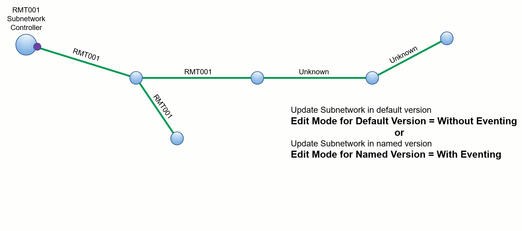

    The following example illustrates the impact of updating a subnetwork on the RMT001 subnetwork following the creation of a line, when the tool is run in the default version, or when the tool is run in a named version and the Edit Mode for Named Version parameter is set to With Eventing. While only one feature is edited, all features in the subnetwork are updated with the subnetwork name.
    Update subnetwork operation run in the default version (With Eventing and Without Eventing) and in a named version using With Eventing.
