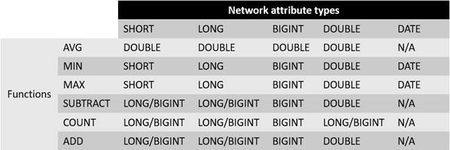

  • When defining summaries as part of the Subnetwork Trace Configuration parameter category, the Function and Attribute values filter the list of available fields for the summary attribute. The following matrix of valid field types can be used to define the Summary Attribute field based on the specified function and network attribute field type. For example, to create a summary to report the average from a network attribute type of long, you can create a field of type double on the SubnetLine feature class and specify it as the Summary Attribute field.
    Network attribute types matrix
    This is a matrix of valid field types for the summary attribute field based on the specified function.
