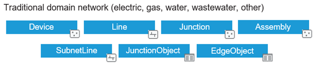

Each traditional domain network consists of five feature classes and two tables that are created when you use the Add Domain Network tool to add a domain network: Device, Line, Junction, Assembly, SubnetLine, JunctionObject, and EdgeObject. These classes are created with system-provided attribute domains assigned to system fields for use by the utility network and require additional configuration for use. Additional classes cannot be added to a domain network.
Classes in a traditional domain network
The five feature classes are described as follows:
  • Device—Represents point features such as valves, meters, transformers, and switches. These are compact features through which the utility resource flows, and devices can affect the resource in several ways. For example, a valve controls the flow of water; a transformer changes electrical power from one voltage level to another; or a meter measures the gas, water, or electricity consumed by the customer. Devices can have terminals when there are distinct entry points to the device. Devices can be connected to other devices, junctions, and lines. Devices can be contained in assemblies as well as in structure junctions, structure lines, or structure boundaries, which are containers.
  • Line—Represents linear features such as wires and pipes. These are the lines that deliver the utility resource, such as gas, water, electricity, or communications.
  • Junction—Represents locations where lines connect to lines or lines connect to devices. A key use of junction features is to allow devices or lines to connect to another line at an intermediate vertex. Junctions are placed as needed to complete the connection of all the features of a utility network.
  • Assembly—Represents point features that contain other features. As with device features, assembly features are compact features, but they differ in that assemblies contain other significant devices. Assemblies are useful to show a single symbol on the map yet model the internal features and their connections. You can view the internal features of an assembly on the map or in the diagram view. Examples of assembly features are switchgear, transformer banks, and pump assemblies.
  • SubnetLine—A collection of subnetwork lines that define the current extent of a resource flow. For water or gas utilities, subnetworks are called pressure zones. For electric utilities, subnetworks are called circuits or feeders. Subnetworks are not directly edited like the other features in a domain network. Rather, they are generated by a command to update subnetworks. This command traces the flow of a resource from a subnetwork controller (such as a substation or water tank) through all the devices and lines until either that resource is consumed or the flow is blocked by an interrupting device such as a switch or valve. Because of switching devices, subnetworks frequently change and can be quickly regenerated on demand.
The two tables are described as follows:
  • JunctionObject—Represents nonspatial junction objects such as racks or ports that are contained or associated with other network features. Junction objects can have terminals when there are distinct entry points for the object.
  • EdgeObject—Represents nonspatial edge objects such as fibers in a cable. These are stored in a table due to the large number of features that may be contained in a cable.

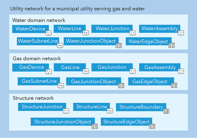

A utility network consists of one or more domain networks and a structure network. The following diagram shows the classes in a utility network for a municipal utility that uses both a traditional gas and water domain network to serve its customers:
Example set of domain networks for a municipal utility
