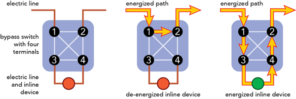

A bypass switch allows an inline electric device, such as a voltage regulator, to either function in an energized state or become de-energized for maintenance.
This type of switch is modeled as a four-terminal device. There are six possible paths between the four terminals, but the valid paths defined in the terminal configuration either energize or de-energize the inline device.
Bypass switch in various states
The middle device above shows the bypass switch isolating the inline device by restricting the valid path to travel from terminals 1 to 2. The third device above shows the bypass switch energizing the inline device by allowing the flow of electricity to travel along two valid paths: 1 to 3 and 4 to 2.
