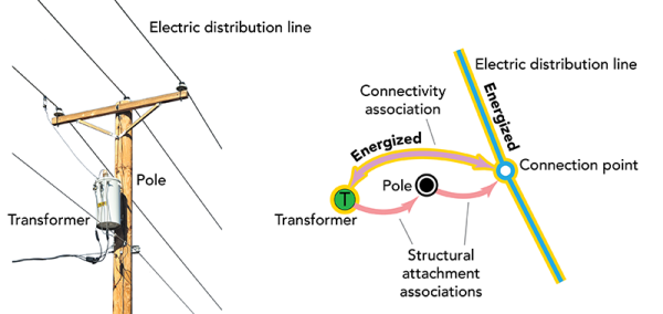

Conceptual view of connectivity associations in a network
In the diagram above, the transformer is connected to a connection point on an electric distribution line. This establishes a connection without the transformer needing to be coincident with the connection point. This connection represents the physical jumper between the transformer and the connection point in the real world.
