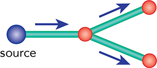

If the domain network is defined with the source subnetwork controller type, a resource can only flow away from or exit subnetwork controllers, not toward or into them.
Source-based subnetwork

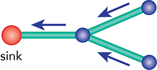

If the domain network is defined with a sink subnetwork controller type, a resource can only flow toward and enter subnetwork controllers, not away from or exit them.
Sink-based subnetwork
