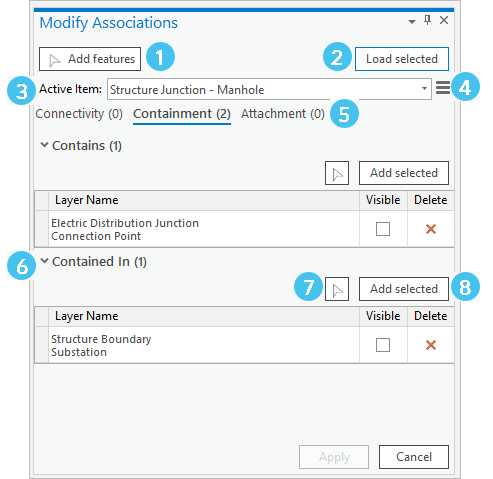

The Modify Associations pane is used to create, select, modify, and delete associations between network features. This pane is used to check association rules to ensure the selected features or objects can connect, attach, or participate in containment. You can create network rules to allow associations to be established between network features as long as utility network feature restrictions are honored.
The Modify Associations pane provides the following elements to work with and manage associations between network features:
Elements of the Modify Associations pane
Element
Description
Add features Edit Vertex—Use this command to select one or more features on the map to populate the Active Item drop-down menu.
Load selected—Use this command to populate the Active Item drop-down menu with a selection on the map or from the attribute table.
Active Item—Use this drop-down menu to specify the target feature or object to work with when multiple items are selected or loaded in the pane.
Modify Associations Menu Menu—Use this drop-down menu to access additional options to work with and manage associations in the pane. See the Modify Associations menu section below for details.
5
Association tabs—Use the tabs at the top of the pane to switch between association types for the network feature set as the active item. The number of associations for each type is displayed by an indicator next to the Connectivity, Containment, and Attachment tabs. Some tabs may not be visible depending on the active item selected.
6
Sections—Expand or collapse the sections on each association tab to work with associations for the active item. Some sections may not be visible depending on the active item selected.
7
Add features Edit Vertex—Use this command to select one or more features on the map to populate the specified section.
8
Add selected—Use this command to populate the specified section from a selection on the map or from attribute tables.

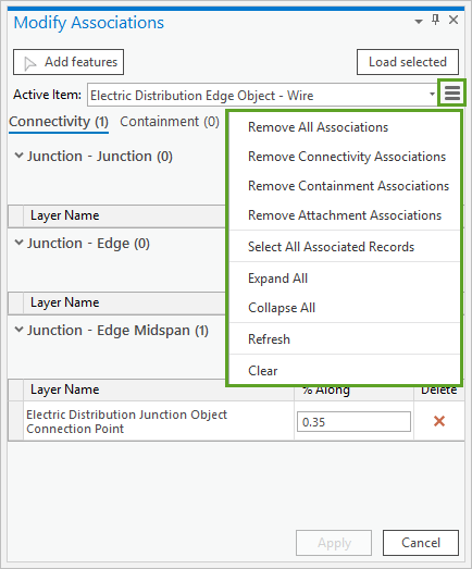

The Modify Associations menu options for working with and managing associations in the pane are described below:
  • Remove All Associations—Mark all associations for the network feature on the Active Item drop-down menu across all association tabs to be deleted.
  • Remove Connectivity Associations—Mark all connectivity associations for the Active Item value to be deleted.
  • Remove Containment Associations—Mark all containment associations for the Active Item value to be deleted.
  • Remove Attachment Associations—Mark all attachment associations for the Active Item value to be deleted.
  • Select All Associated Records—Create a selection of all features and objects with associations to the Active Item value.
  • Expand All—Expand all sections across all the association tabs.
  • Collapse All—Collapse all sections across all the association tabs.
  • Refresh—Refresh the pane to display the existing associations for the Active Item value. This option allows you to refresh the pane following validation or to revert changes that have not been applied in the pane such as the creation of associations or those marked for deletion.
  • Clear—Clear the Modify Associations pane of the active item and all associated network features.

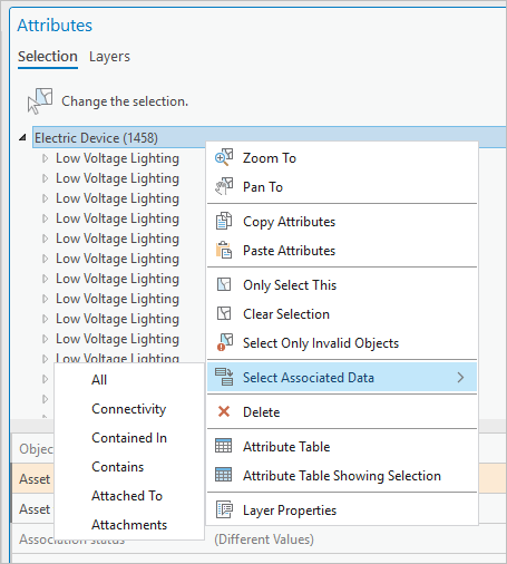

Select associated data in the Attributes pane
The Attributes pane contains the Select Associated Data command that exposes a list of valid association types for the selected feature or object that can be used for selection of associated data. Valid association types are determined by the Association status attribute of the selected feature or object. The selection created by the Select Associated Data command is added to the current selection in the Attributes pane.
Select Associated Data command displays valid association types for the layer.
Learn more about how to view and edit utility network feature and object attributes
The following options are available on the Select Associated Data command:
  • All—Select all associated features or objects.
  • Connectivity—Select network features with connectivity associations to the selected feature or object.
  • Contained In —Select the container associated with the selected content feature or object.
  • Contains—Select content features associated with the selected container.
  • Attached To—Select structure features or objects associated with the selected item through a structural attachment association.
  • Attachments—Select attached features or objects associated with a selected structure through a structural attachment association.
You can use the Select Associated Data command for an individual network feature in the pane's selection tree view or perform a bulk selection of associated data by right-clicking the layer to select associated data for all selected network features.
Note:
Selections are organized by layer in the pane and can contain multiple items. When a large selection of features or objects is present in the Attributes pane and you right-click the layer, the Select Associated Data command displays all association types, regardless of whether valid associations are present for the selection.
To select associated features and objects for the selected items in the Attributes pane, complete the following steps:
  1. On the Edit tab, in the Selection group, click Attributes .
  2. Select the features or objects in the network to be added to the pane.
    1. Click the Selection tab.
    2. Click the Select tool to select features in the map.
      Alternatively, create a selection in the attribute table.
  3. Select the associated data for the selected items by doing one of the following:
    • Right-click the feature or object to select associated data for the specific network feature.
    • Right-click the layer to perform a bulk selection of associated data for all selected network features in the layer.
    1. Right-click the layer or selected feature or object.
      A context menu containing various commands to work with the selection is displayed.
    2. Click the Select Associated Data command to display valid association types for the selected network features.
    3. Select an association type from the list.
      Associated data for the selected item is added to the selection in the Attributes pane.
