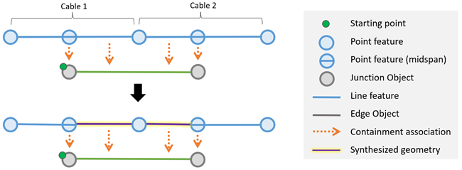

For scenarios in which you want to visualize the path of a trace through edge objects, the aggregated geometry result type option on the Trace and Add Trace Configuration tools can be used with the Synthesize Geometries parameter to infer and create geometry for edge objects that are traversed as part of a trace.
The geometry for an edge object can be synthesized in two ways. When an edge object is the content of a line, geometry is inferred from the spatial container. When an edge object has no spatial containment and this is not possible, geometry is synthesized between the endpoints of the edge object.

In the example below on the left, you can see junction and edge objects (in gray) contained by spatial point and line features (in blue) through a containment association (in orange). Looking at the image on the right, if you were to place a starting point on one of the junction objects and run the trace, geometry is synthesized and returned (in highlighted purple) in the aggregated geometry result. When geometry is inferred from an edge object's spatial container, the original container geometry is preserved.
The trace preserves the container geometry of the edge object when synthesizing geometry in the aggregated geometry result.

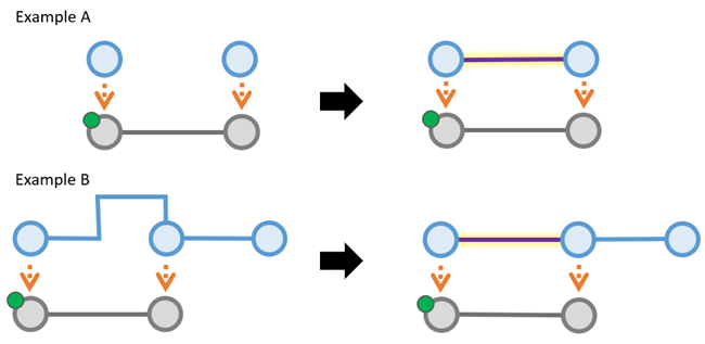

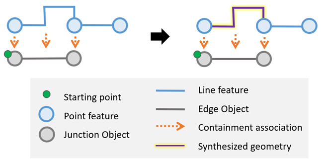

The examples below demonstrate scenarios in which the edge object (in gray) is not contained by a spatial feature. In example A, there is no line feature present. The endpoint junction objects (in gray) are instead content of the point features (in blue). When the trace is run, geometry is synthesized as a straight line between the endpoints as shown on the right (in highlighted purple). In cases in which an endpoint's container is nonspatial, locations are derived from the first spatial feature in the containment hierarchy. Example B outlines a similar scenario. Looking at the image on the left, you can see a line feature (in blue); however, it does not contain the edge object. In this case, on the right, when the trace is run, the line feature's original geometry is not preserved when synthesizing geometry (highlighted purple) because the edge object is not content.
The trace synthesizes geometry between the endpoints of the edge object when there is no spatial linear feature in the containment hierarchy for the edge object.

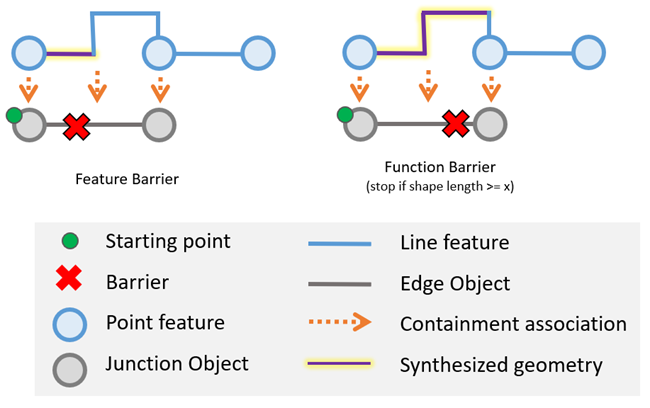

Because the Synthesize Geometries parameter is supported in conjunction with the Aggregated Geometry result type, the location of starting points and barriers placed midspan along an edge object can be used to return partial geometries when edge objects are content of a line feature. By default, trace locations are placed along edge objects with a percent along value of 0.5. This can be modified by editing the PERCENTALONG field for the starting point in the UN_Temp_Starting_Points and UN_Temp_Barriers feature classes.
The two scenarios below outline examples in which a barrier is present midspan along an edge object. The PERCENTALONG value is evaluated against the edge object's container geometry to return partial geometry in the aggregated geometry result. When an edge object is not content of a line feature, PERCENTALONG is ignored and the entire geometry between the endpoints is returned.
Trace locations placed midspan along an edge object can be used to return partial geometries in the result when it is content of a linear feature.

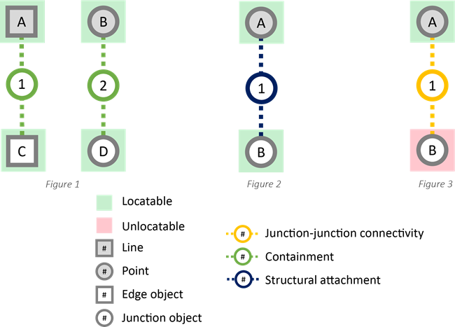

The locatability of nonspatial objects is important because spatial features provide a mechanism to create dirty areas and validate edits made to nonspatial objects so they can be updated in the network topology. Junction and edge objects are considered locatable when they are connected to, contained by, or structurally attached to a spatial feature in their association hierarchy.
In figure 1 below, edge object C and junction object D are locatable through containment associations with spatial features, line A and point B, respectively. Similarly, in figure 2, junction object B is locatable through a structural attachment association with point feature A.
It is important to note that junction-junction connectivity associations cannot be used to determine the locatability of a junction object or edge object. Figure 3 shows that even though junction object B is associated with point feature A through a junction-junction connectivity association, it is considered unlocatable without another containment or structural attachment association to another feature or locatable object.

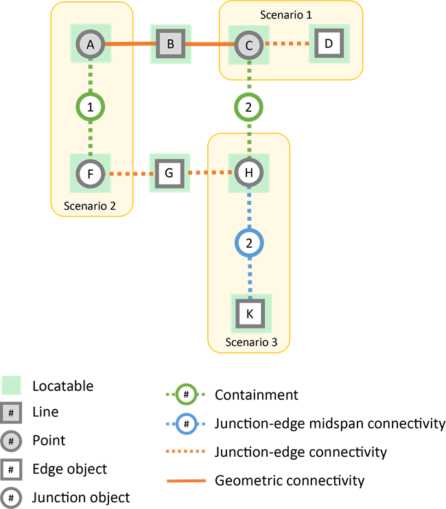

An edge object may also be located when associated with a junction at its endpoints or in situations in which the edge object is associated with a locatable junction object through a junction-edge or junction-edge midspan connectivity association.
For an example, see the scenarios below:
  • In scenario 1, edge object D is locatable through a junction-edge connectivity association with point feature C.
  • In scenario 2, edge object G is locatable through a junction-edge connectivity association with junction object F, which is locatable through containment association 1 with point feature A.
  • In scenario 3, edge object K is locatable through a junction-edge midspan connectivity association with junction object H, which is locatable through containment association 2 with point feature C.
Locatability scenarios for edge objects through containment and connectivity associations
