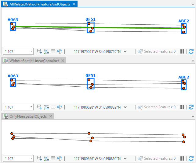

The diagram maps below show diagrams representing all or parts of these network features and their nonspatial content objects.
Diagrams representing the sample set of network features and their related nonspatial objects
In all cases, each diagram feature geometry is initialized in the same way:
  • When they remain in the generated diagrams, the connection points that are spatial containers are represented as blue polygon diagram containers. Each one is centered as closely as possible to its associated connection point location and is drawn around its contents.
  • When it remains in the generated diagrams, the medium-voltage linear container is represented as a sequence of diagram edges that connect the center of their from and to blue polygon diagram containers.
  • The content junction objects are represented as orange diagram junctions and positioned by default inside their blue polygon diagram containers.
  • These junction objects are from or to junctions of wire edge objects that are represented as dark gray diagram edges.

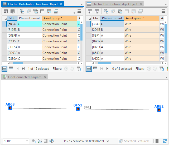

You can open the network junction and edge object tables and click any object rows to use them as the only input for diagram generation.

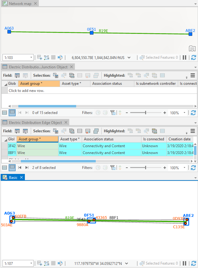

  • For example, the diagram below is based on the Basic diagram template and shows two wire edge objects selected as input in the Electric Distribution Edge Object table.
    Sample diagram based on the Basic template
    This sample diagram is based on the Basic template and shows two distribution edge objects selected as input.

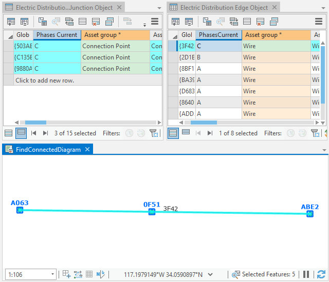

  • The diagram below is based on a custom template configured to automatically run a Find Connected Trace rule from the network elements specified as input and systematically remove linear containers that may exist at the end of diagram building. It shows a single junction object selected as input in the Electric Distribution Junction Object table.
    Diagram based on a custom template
    This diagram is based on a custom template generated from a single junction object selected as input.

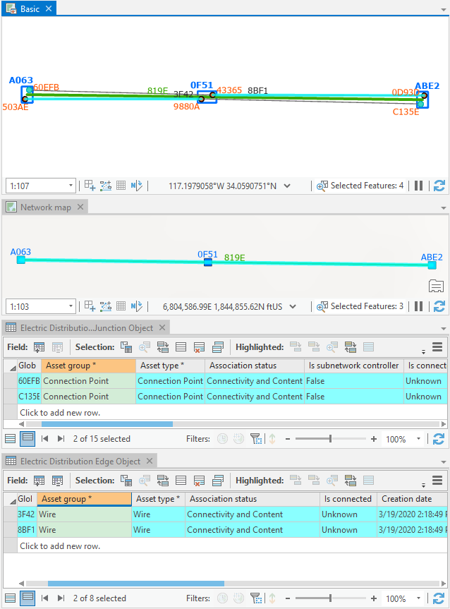

For example, the images below show the result of the Apply To Maps command when it is run from the Basic diagram map. Since the two diagram junctions and two diagram edges selected in the diagram represent junction and edge objects, the corresponding network object rows are selected in the object tables in the network map:
Network objects selected in the nonspatial tables after clicking Apply To Maps

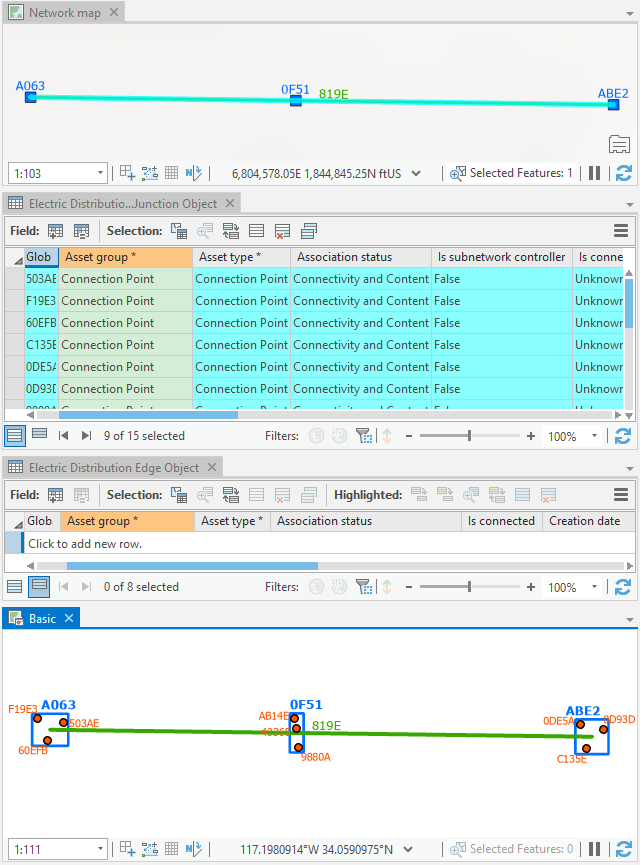

In this use case, if you want the propagation process to systematically select the spatial container features related to the selected network objects in the object table in the network map, check the Select spatial container(s) when propagating edge and junction objects represented in diagram map option on the Network Diagram tab on the Network Options dialog box. The image below shows the result of the Apply To Maps command when it is run from the Basic diagram map.
Apply to Maps command run from the Basic diagram map.
