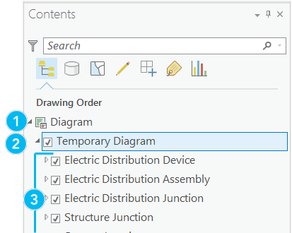

In ArcGIS Pro, any newly generated network diagrams appear in a diagram map view (number 1 in the image below). This is done through a network diagram layer (number 2 in the image below), which is a specific type of composite layer.
Diagram map, network diagram layer, and layers under a network diagram layer
Network diagram layers can only be accessed in an open map view.
Most aspects of each layer or subtype group layer under a network diagram layer (number 3 in the image above) can be controlled with commands on the ribbon, as with any other layer, on the Feature Layer tab set and the Layer Properties dialog box.

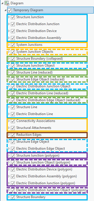

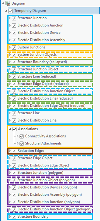

By default, when the All Layers mode is turned on, this network diagram layer is composed of the following layers:
  • One standard layer for each network feature source class or object table that composes the network (highlighted in blue below)
  • An additional set of standard layers
    • Layers to represent four specific network elements (in orange below):
      • Two layers, System Junctions and System Junction Objects, are dedicated to the representation of the system junctions along the line features and edge objects. These network elements are never represented in your geographical map, but they may become visible in your diagrams when they exist as a from or to junction for a network line or edge object that is represented in the diagram.
      • Two layers, Connectivity Associations and Structural Attachments, are dedicated to the representation of the connectivity and structural attachments associations. These associations may be represented as edges in your diagrams when there is an Add Connectivity Associations or Add Structural Attachments rule configured on the diagram template.
        Note:
        Starting with Utility Network Version 6, these layers are managed under the Associations subtype group layer for all diagram templates. This change also becomes automatic for all diagram templates related to any utility network created prior once it is upgraded to Version 6. Using a subtype group layer for these diagram edges allows performance gains when displaying and editing network diagrams.
    • One layer for each container polygon feature, line feature, or edge object of the network that may be transformed as a point feature in your diagrams (in green below). These diagram point features may be created in your diagrams when there are Collapse Container or Reduce Edges rules configured on the diagram template to transform container polygon features, line features, or edge objects as diagram points.
    • One layer for each container point feature or container junction object of the network that may be transformed as a polygon feature in your diagrams (in purple below). These diagram polygon features may be created in your diagrams when there are Expand Container rules configured on the diagram template.
    • Layers to represent schematic edges; that is, pure diagram edges:
      • One layer, Reduction Edges (in brown below), represents network elements that may be aggregated in your diagrams. These reduction edges may be created in your diagrams when there are Reduce Junction or Collapse Container rules on the diagram template.
      • Two layers are dedicated to the representation of specific schematic edges that can be created when generating network diagrams related to a utility network with a telecom domain network; Virtual Connectivity that is used to represent implicit connections between two sections, and Inferred Connectivity to represent implicit connections between two contained network elements.
        Note:
        These two additional layers do not exist in Utility Network versions prior to 8 and are created only when a telecom domain exists for the utility network.
