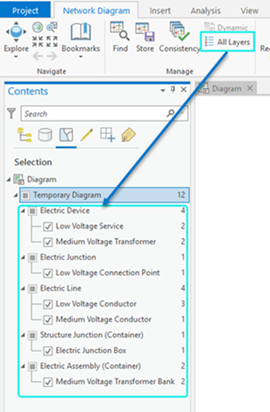

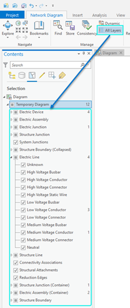

  • Checked—The All Layers mode on the Manage group on the Network Diagram tab is turned on for each network diagram layer when it is loaded by default; that is, any diagram opens with all the sublayers as specified in its diagram template layer definition, whether they contain diagram features or not. This means that all sublayers set on the related diagram template are present in the Contents pane, even those not used.
  • Not checked—The All Layers mode on the Manage group on the Network Diagram tab is turned off for each network diagram layer when it is loaded by default; that is, any diagram opens with the only diagram template sublayers that contain diagram features. This means that only the required sublayers among those set on the related diagram template are present in the Contents pane.
By default, the Open diagrams with all diagram template sublayers option is unchecked; that is, any network diagram layer displays with the All Layers mode turned off by default on the Manage group on the Network Diagram tab. Running with this option unchecked allows you to gain performance at any diagram opening, especially when only a few layers are required to display all the diagram features. Use this mode to open diagrams for simple viewing, applying diagram layouts, or white space editing.

mode is turned off; that is, only the required sublayers—those that really contain diagram features—are present in the
However, check this option before working with network diagrams for which you already know that the content is going to be increased or decreased during your workflow, for example, when you are going to work with the Dynamic Diagram mode, or run commands such as Extend Diagram, Append to Diagram, or Overwrite Diagram to refine your diagram content. You will typically perform these operations when working with diagrams to control network connectivity or explore the network.

mode is turned on; that is, all the sublayers are present in the
Note:
In all cases, you can also switch the network diagram layer you are working on to the other mode at any time by clicking the All Layers button on the Manage group on the Network Diagram tab. Be aware that manually turning this mode on or off is time consuming for network diagram layers that are already loaded.
All Layers turned off (default)
All Layers turned on
Gain performance at diagram opening.
Required before processing operations such as Extend Diagram, Append to Diagram, and Overwrite Diagram.
Maximize performance when applying diagram layouts, updating diagrams, or editing white space.
Required to enable dynamic diagram mode on a temporary diagram.
