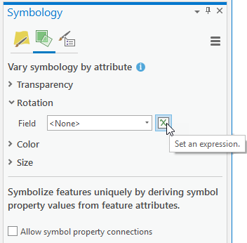

  4. At the top of the Symbology pane, click the Vary symbology by attribute tab.
  5. Expand the Rotation section and click Set an expression:
    Rotation section on the Vary symbology by attribute tab
    Caution:
    Do not select Element rotation directly in the Field list at the right of the Set expression button. The Arcade expression initialized by default, in this case, looks similar to the following one—$feature.UN_5_TmpJunctions.ROTATION—and is invalid. Be sure the expression you specify is based on one of the following syntax examples instead:
    • Arcade: $feature['UN_5_TmpJunctions.ROTATION']
    • VBScript: [UN_5_TmpJunctions.ROTATION]

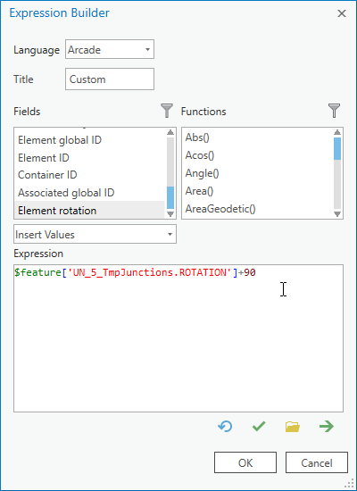

  6. On the Expression Builder dialog box that appears, in the Fields list, double-click the Element rotation field.
  7. Depending on the initial orientation of the symbols used and the rotation style—geographic or arithmetic—consider adding 90 in the Expression field so the orientation of the symbol shown in the Contents pane and in the diagram are the same when Element rotation is zero.
    Custom expression to rotate diagram junctions
  8. Click OK.
