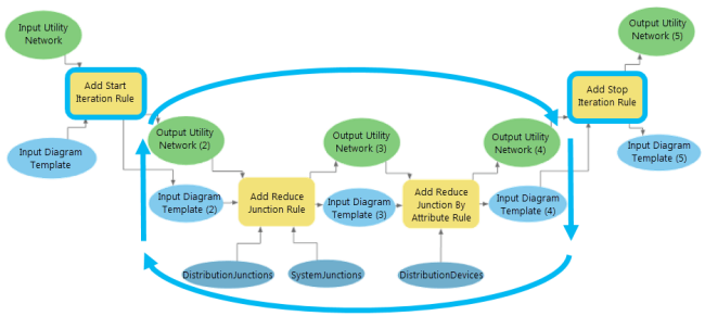

Two specific rules are required to make your rule sequence iterative when you need to configure multiple reduce junction rules with junctions that connect one other junction and consequently change the number of junctions connecting the remaining target junctions during their run: Start Iteration and Stop Iteration.
  • The Start Iteration rule is used to notify the beginning of a rule sequence on which the diagram builder process will iterate or loop.
  • The Stop Iteration rule is used to notify the end of a rule sequence on which the diagram builder process must iterate or loop.
These two specific rules are particularly useful when configuring rule sequences that chain several reduce junctions rules. Since reduce junction rules connecting one other junction change the number of connections of the remaining junctions, those remaining junctions potentially become new candidates for a reduction rule that was previously run. Because of the Start and Stop rules, the build process iterates on the identified sequence until there are no longer any junctions to reduce.
To add a Start Iteration rule and a Stop Iteration rule on a template, use the Add Start Iteration Rule and Add Stop Iteration Rule tools.
Start and Stop Iteration rules sample

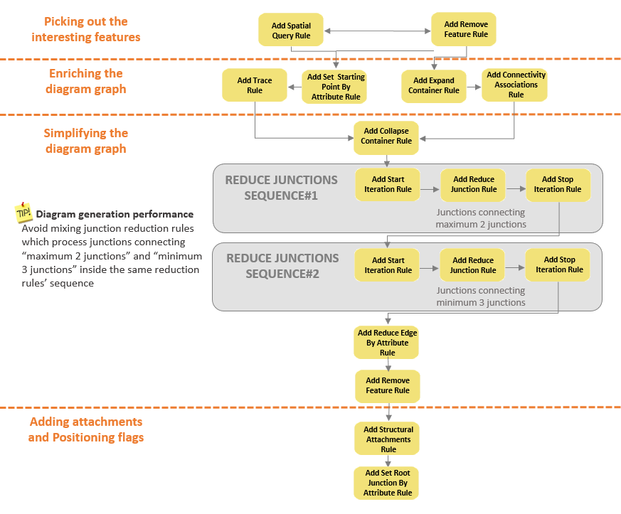

Caution:
Reducing junctions that connect three or more other junctions is time consuming and must be processed after all other reduce junction rules complete. To optimize diagram generation and update performance, avoid mixing junction reduction rules that process junctions connecting a maximum of two other junctions and a minimum of three other junctions inside the same iterative sequence. The recommended workflow is as follows:
  1. Configure a first iterative sequence of reduction rules to process junctions that connect a maximum of two other junctions.
  2. Configure a second iterative sequence of reduction rules to process junctions that connect a minimum of three other junctions.
Recommendations and warnings for rule process
Keep the following in mind when configuring diagram rules:
  1. Remove Features rules—Configured using the Add Remove Feature Rule, Add Remove Feature By Attribute Rule or Add Remove Feature By Category Rule tools, Remove Features rules can be run at the first position of the rule sequence to systematically discard particular network features or network objects from the diagram before refining the diagram graph.
    For example, apply the Add Remove Feature Rule tool with the Exclude source classes rule process to discard any network features or network objects related to all network source classes and object tables except some specific network source classes or object tables. Also, since graph completeness is always maintained in network diagrams, excluding a particular line class (for example, a transmission line) while running Source Type = EDGES may be helpful to ensure your diagrams build on a given part of the network, in other words, the transmission network in this example.
  2. Spatial Query rules—Added using the Add Spatial Query Rule tool, Spatial Query rules can be set up in the rule sequence at any time but may be useful at the beginning of the rule sequence to include all features of interest.
  3. Trace rules—Added using the Add Trace Rule tool, Trace rules are generally one of the first rules you set up in the rule sequence when you want to configure a template to generate diagrams from traces. In this case, you can also configure Set Starting Point rules on the template to set specific features or junction terminals as starting points for the Trace rule to process. Starting Points rules must be set up before the Trace rule in the diagram template rule sequence using the Add Set Starting Point By Attribute Rule tool.
  4. Expand Containers rules—Configured using the Add Expand Container Rule, Add Expand Container By Attribute Rule or Add Expand Container By Category Rule tool, Expand Containers rules allow you to expand containers in diagrams. They are generally set up before any rules that simplify the diagram graph.
  5. Add Connectivity Associations rule—Configured using the Add Connectivity Associations Rule tool, Add Connectivity Associations rules can be set up to get the connectivity associations represented in the diagrams and ensure graph completeness before collapsing or reducing features.
    Caution:
    Avoid configuring this rule when it is not needed because it is time-consuming. For example, adding connectivity associations is not relevant to a template configured to run a Trace rule, since the connectivity associations will already be systematically returned by the trace.
  6. Add Diagram Feature Capability rules—Added using the Add Diagram Feature Capability By Attribute Rule or Add Diagram Feature Capability By Category Rule tool, Add Diagram Feature Capability rules can be set up to manage collapsing of containers or reduction of junctions with precision. They can be used to prevent particular containers from collapse or particular junctions to be reduced during all or part of the diagram building.
  7. Collapse Containers rules—Set up when running the Add Collapse Container Rule, Add Collapse Container By Attribute Rule or Add Collapse Container By Category Rule tool, Collapse Container rules are run to collapse containers in diagrams. They must be performed after the Expand Container rules if you want to keep track of all contents related to the collapsed containers.
  8. Start Iteration rules—Configured using the Add Start Iteration Rule tool, the Start Iteration rule must be positioned at the beginning of a Reduce Junction rule iterative sequence. It forces the building diagram process to loop on the Reduce Junction rule sequence until there are junctions in the diagram, which is reduced by one of the rules in that sequence.
  9. Reduce Junction rules—Added when running the Add Reduce Junction Rule, Add Reduce Junction By Attribute Rule and Add Reduce Junction By Category Rule tools, Reduce Junction rules are used to simplify the diagram graph.
    Caution:
    During configuration, do not use Reduce Junction rules that process junctions connecting a maximum of two other junctions with Reduce Junction rules that process a minimum of three other junctions inside the same reduction rules' iterative sequence. Using these together decreases performance at diagram generation. To reduce junctions connecting a minimum of three other junctions, set up two iterative sequences—the first one to process the reduction of junctions connecting a maximum of two other junctions and the second for the reduction of junctions connecting a minimum of three other junctions.
    Tip:
    Because content diagram junctions do not aggregate noncontent diagram features, you can configure a Remove Feature rule before reducing junctions to remove any polygon containers and all content-container relations in the diagram and force reductions.
  10. Stop Iteration rules—Configured using the Add Stop Iteration Rule tool, Stop Iteration rules must be positioned at the end of a Reduce Junction rule iterative sequence, in other words, just after the last Reduce Junction rule in the sequence where you want the build process to iterate.

The following diagram illustrates the recommended position for each rule in the rule sequence according to the recommendations outlined above:
Recommended position for each rule in a rule sequence
Note:
Keep in mind that each rule is optional, and most of the usual rule sequences configured for a diagram template fit various parts of the sequence detailed above.
