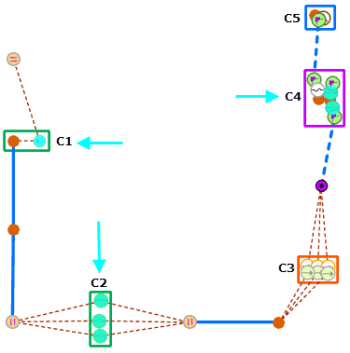

The graphics below exemplify a use case when collapsing diagram features:

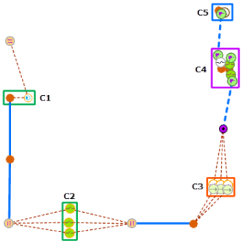

  • Graphic A shows the sample diagram. It references five container features:
    • Two switch banks—C1 and C2
    • One fuse bank—C3
    • One switchgear—C4
    • One transformer bank—C5
    These containers are all expanded and represented as diagram polygon containers around their contents.
    Containers C1 through C5 as expanded diagram polygon containers
    Graphic A—All containers, C1 through C5, are shown as expanded diagram polygon containers.

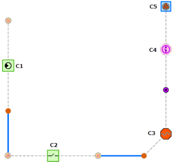

  • Graphic C shows the sample diagram obtained when the template is configured to collapse all containers.
    Containers systematically collapsed
    Graphic C—All containers are systematically collapsed.

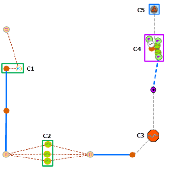

  • Graphic D shows the sample diagram obtained when its template is configured with the Prevent related container from collapse capability on all switches before collapsing all containers.
    Containers systematically collapsed except those containing switches
    Graphic D—Containers are systematically collapsed except those containing switches.

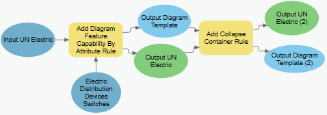

Between the two templates used to produce graphics C and D, there is a difference in the rule definition. A Diagram Feature Capability rule is applied before the Collapse Container rule.
Simple Collapse Container rule
Collapse Container rule after setting capabilities on diagram features

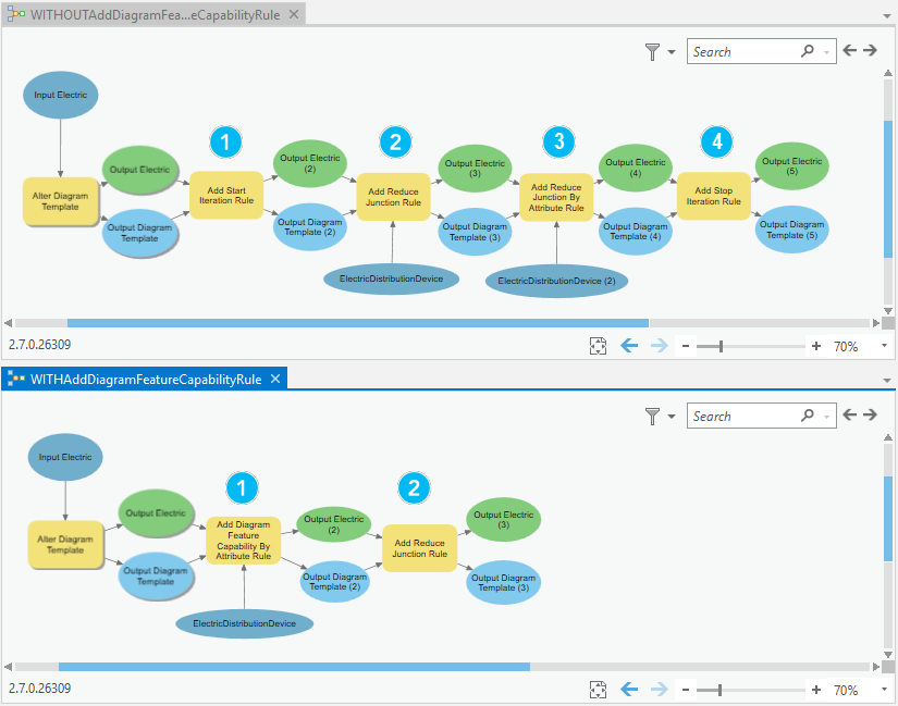

Using the Add Diagram Feature Capability By Attribute Rule or Add Diagram Feature Capability By Category tool in a diagram template model builder can simplify the reduce junction rule sequence configured on a diagram template.
For example, suppose that you want to reduce all junctions in your diagrams except switches. There are two ways to configure the diagram building—one way will not run the Add Diagram Feature Capability rule and the other way will run it.
Diagram template model builders with and without the Add Diagram Feature Capability By Attribute Rule tool
Without using the Add Diagram Feature Capability By Attribute Rule or Add Diagram Feature Capability By Category tool, your model builder must iterate on two Reduce Junction rules; that is, it must be configured to chain four rules, as shown below:

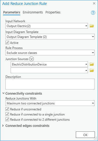

  • A Start Iteration rule (1)
  • A Reduce Junction rule to reduce any junctions excluding those in the DistributionDevice source class (2)
    Rule reducing any junctions excluding those in the DistributionDevice source class

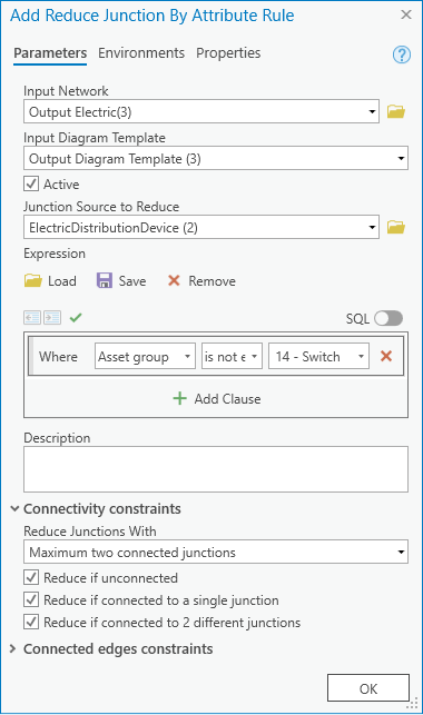

  • A Reduce Junction rule to reduce any distribution devices except switches (3)
    Rule reducing any distribution devices except switches
  • A Stop Iteration rule (4)

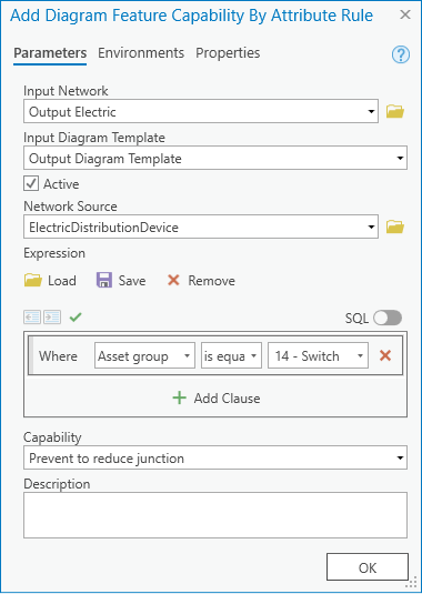

When using the Add Diagram Feature Capability By Attribute Rule tool, two rules only are needed:
  • An Add Diagram Feature Capability rule to prevent switches from being reduced (1)
    Rule preventing switches from being reduced

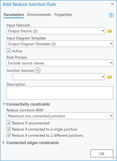

  • A Reduce Junction rule to reduce any junctions regardless of their source class (2)
    Rule reducing any junctions regardless of their source class

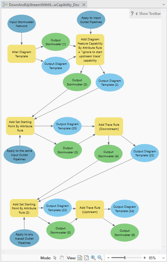

Ignore to start upstream or downstream trace
Enabling the Ignore to start upstream trace or Ignore to start downstream trace capabilities on a diagram feature will make this feature to be not considered as a starting point by any Trace rule configured later in the rule sequence to trace upstream or downstream.
For example, suppose that you want to create a custom template to generate diagrams starting from any input pipe outlets that will represent both downstream traces to these input pipe outlets and upstream traces related to the only traced downstream pipe outlets. In this case, at the beginning of your custom template rule sequence, you can set the Add Diagram Feature Capability By Attribute Rule tool with the Ignore to start upstream trace capability to flag any input pipe outlets to be ignored as starting points by any upstream trace that could be configured later in the rule sequence. The geoprocessing model to create such a diagram template should look like the following model:
Sample use of the Ignore to start downstream trace capability

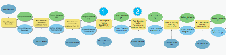

Configuring the Add Diagram Feature Capability rule at judicious positions in a diagram template rule sequence also allows you to prevent some features that exist at the time the rule runs from being collapsed or some devices with specific characteristics from being reduced while devices with the same characteristics but introduced later in the diagram building process will be reduced.
For example, imagine you want to generate diagrams that will represent both the upstream and downstream trace result starting from a transformer bank or a distribution junction selected as input in the map. Then, you want to keep some interesting upstream junctions while reducing any downstream junctions as much as possible to mainly focus on service locations. In this case, the Add Diagram Feature Capability rule can be used multiple times, as shown in the diagram template model builder below.
  • In the first part of this template model builder, you must focus on the transformer bank or distribution junction that the template expects as the input starting point for the upstream and downstream traces. To do so, you can set up the model as follows:
    • Add Remove Feature rules to remove any network features that could be selected as input but is not a transformer bank nor a distribution junction tied to the tier you want to trace.
    • Set up Add Diagram Feature Capability rules to prevent the container related to transformer banks (1) or to distribution junctions (2) to collapse.
    • Flag the input transformer bank or distribution junction as the starting point for the trace rules that will be applied in the next phases.
    Diagram focusing on the input starting points

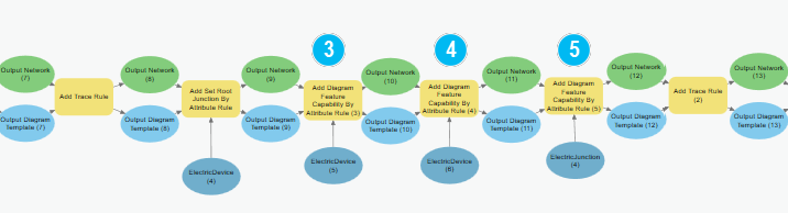

  • The second part of the template model builder concerns the trace rules.
    • Begin with an upstream trace that will be run from the specified starting point.
    • Flag the upstream subnetwork controller returned by the upstream trace as the root junction for the tree layout that will be run at the end of the network diagram building process.
    • Set up an Add Diagram Feature Capability rule (3) to prevent the upstream subnetwork controller container to collapse.
    • Set up an Add Diagram Feature Capability rule (4) to prevent any upstream devices such as switches, fuses, transformers, circuit breakers, and the subnetwork controller to be reduced.
    • Set up an Add Diagram Feature Capability rule (5) to prevent any upstream junctions such as connection points to be reduced.
    • Run the downstream trace. It will perform from the same starting point as the upstream trace.
    Diagram tracing upstream and preventing some upstream traced junctions from being collapsed and reduced before tracing downstream

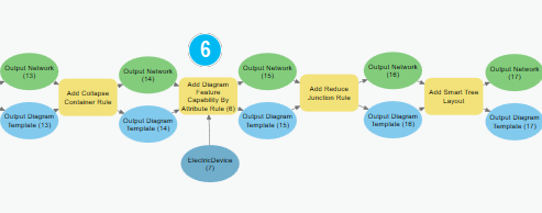

  • During the last phase, you set up the diagram rules that will simplify the network diagram graph and lay it out:
    • Add a Collapse Container rule to collapse any containers.
    • Set up an Add Diagram Feature Capability rule (6) to prevent any service location devices from being reduced.
    • Add a Reduce Junction rule to reduce any diagram junction regardless of its related network source class.
    • Run a Smart Tree layout from top to bottom.
    Diagram preventing service locations from being reduced and reducing all junctions as much as possible

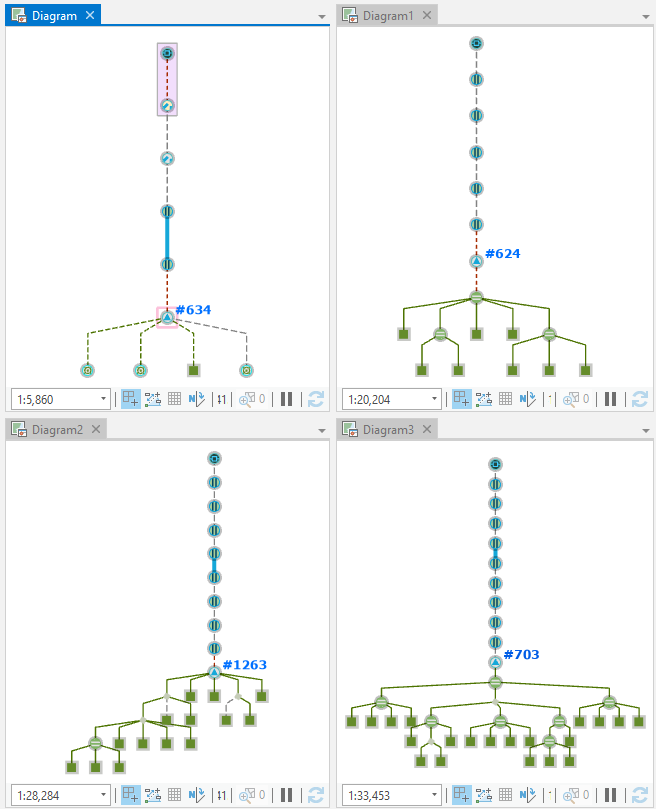

The following screenshot shows some sample network diagrams based on a diagram template configured with the template model builder explained above. The transformer bank used as input for each network diagram generation displays with a blue label showing its Facility ID:
Sample of diagrams mixing upstream and downstream trace results and strongly reducing or collapsing features using Add Diagram Feature Capability rules
