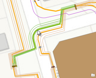

    Graphic B1 shows a linear container used as the only input in the network map for the ExpandContainers diagram generation.

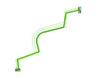

    Graphic B2 shows how this linear container and the two point containers it is connected to are represented in the resulting ExpandContainers diagram. All its own contents and all the contents related to its extremity point containers are represented in the diagram.

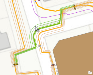

    Graphic C1 shows the linear container—the wide, green line —used as the only input in the network map for the CollapseContainers diagram generation.
