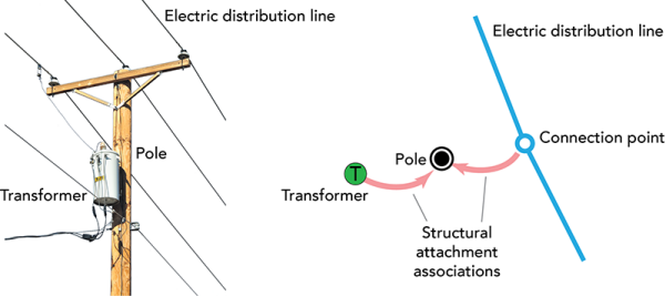

A structure network does not have any resources (such as water or electricity) flowing through it; however, the structure network can support other features that are part of the resource-delivering network. For example, a vault (which is a structure) can contain valves and regulators that are part of the active network delivering the resource. One of the key capabilities of the structure network is the support for structural attachment and containment associations with various domain networks. Structural attachment associations provide an efficient method to identify structures supporting a circuit or subnetwork. Containment associations allow you to model a dense collection of features using a single structure feature that contains other network features. For example, a substation can contain other features such as power transformers, circuit breakers, and busbars. Likewise, a duct can contain multiple cables and fibers. These association types satisfy an organization’s need to rapidly identify which structure, such as a pole, rack, or vault, is associated with a device that may be experiencing an outage.
The illustration below shows conceptually how a transformer and a connection point on the electric distribution line is attached to a pole in the structure network:
Structural attachments with other domain network features

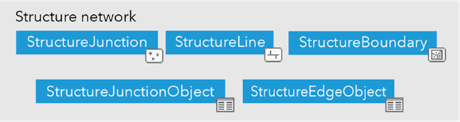

The structure network consists of the StructureJunction, StructureLine, and StructureBoundary feature classes, and the StructureJunctionObject and StructureEdgeObject tables. These feature classes and tables are created with system-provided attribute domains assigned to system fields for use by the utility network and require additional configuration for use.
The following image shows the feature classes and tables that comprise the structure network:
The feature classes and tables in a structure network
The feature classes are more fully described as follows:
  • StructureJunction—Represents structural point features such as poles, pads, vaults, cabinet, or central office that support other features. These are compact features that are tracked in an organization's asset inventory system.
  • StructureLine—Represents linear features such as trenches, span guy, or duct banks. Structure lines contain other network features carrying a resource such as electricity, gas, data, or water.
  • StructureBoundary—Represents polygon container features that contain other network features. For example, a structure boundary can represent the outline of a substation or central office.
The tables are described as follows:
  • StructureJunctionObject—Represents structural junction objects that contain other objects such as fuses or racks.
  • StructureEdgeObject—Represents structural edge objects that contain other objects such as a trench, duct, or microduct.
