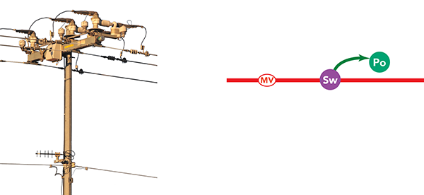

A switch structurally attached to a pole
The illustration above shows how an electric switch is structurally attached to a pole.

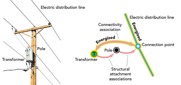

Structural attachment and connectivity associations with electricity
As shown in the image above, a connection point junction is used to attach the electrical line to the pole. It is also used to connect the line to the transformer, allowing electricity to flow. Electricity can flow through the line to the transformer because of the connectivity association from the connection point on the line to the transformer. While electricity does not flow through features such as poles, the trace operation can be configured to include structures for workflows such as pole reports.
