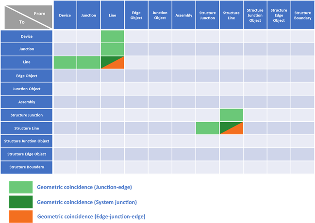

Valid geometric coincidence
Geometric coincident-based connectivity is permitted between a point and line and two lines with an intermediate point feature.
The colored cells indicate valid geometric coincidence between feature classes in a utility network; a rule can be created for specific asset groups and asset types.
If two edge elements share the same endpoint and have the same Asset group and Asset type, these features can connect without a user-defined intermediate junction or network rule. In this situation, a system junction is created and connectivity is established when the network topology is validated or enabled.
Edge-junction-edge connectivity is established between two edges that are connected by an intermediate junction. The dark orange-colored cells above support edge-junction-edge connectivity between features. The table below lists all supported relationships, including the class through which connectivity is established.
Supported edge-junction-edge connectivity between classes:
From class
To class
Via class
Line
Line
Device, Junction
StructureLine
StructureLine
StructureJunction

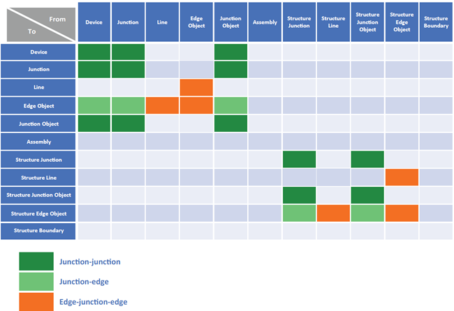

Valid connectivity associations
There are several types of connectivity associations permitted between network features.
Colored cells indicate valid connectivity associations between classes in a utility network; a rule can be created for specific asset groups and asset types.
The dark orange-colored cells above support edge-junction-edge connectivity between network features. The table below lists all supported relationships, including the class through which connectivity is established.
Supported connectivity associations between classes:
From class
To class
Via class
Line
EdgeObject
Device, Junction
StructureLine
StructureEdgeObject
StructureJunction
EdgeObject
EdgeObject
Device, Junction, JunctionObject
EdgeObject
Line
Device, Junction
StructureEdgeObject
StructureEdgeObject
StructureJunction, StructureJunctionObject
StructureEdgeObject
StructureLine
StructureJunction

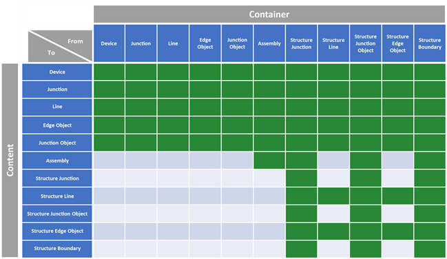

Valid containment associations
In a containment association, network features can serve as containers or content.
Colored cells indicate valid containment associations between classes in a utility network; a rule can be created for specific asset groups and asset types.
Feature restrictions for containment

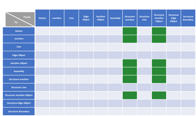

Valid structural attachment associations
In a structural attachment association, network features can serve as a structure or attachment.
Colored cells indicate valid structural attachments between point features or structure junction objects in a utility network; a rule can be created for specific asset groups and asset types.
