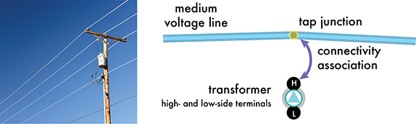

In the example below, junction-edge connectivity is established between the midspan tap junction and a medium-voltage line. A junction-junction connectivity association is then established between the midspan tap junction and the high side of the transformer device. Trace operations travel through the line and the tap point to the connected terminal through the association.
Connectivity association between high-side terminal of transformer and midspan tap

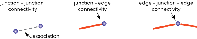

Edge-junction-edge connectivity rules are based on geometric coincidence or connectivity associations. These control the types of line features or edge objects that can be connected using an intermediate junction feature or junction object. This type of rule is useful when you want to ensure that a line does not terminate with a junction. It is important to understand that any conflicting junction-edge connectivity rules for the same junction and edge will override the edge-junction-edge connectivity rule. Edge-junction-edge connectivity rules are evaluated after junction-edge connectivity rules when you enable or validate the network topology.
The following image shows examples of the three types of connectivity rules:
Junction-junction, junction-edge, and edge-junction-edge connectivity

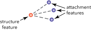

Structural attachment rules constrain the types of network features that can be attached to a given type of asset (structure). This rule type does not support terminal connectivity. Structural attachment rules are created between structure features and attachment features. Attachment features can be from the device, junction, assembly, and structure junction feature classes, as well as junction and structure junction object classes. These rules are established at the asset group and asset type levels and build on existing feature restrictions for valid structural attachment associations.
You must assign an appropriate association role to the class that will serve as the structure before adding structural attachment rules.
Structural attachment rules are evaluated during edit operations. When attempting to establish an association, the respective list of rules is evaluated to confirm the association is valid. If there is no rule to support the association, an error is returned and the network feature is not added to the Modify Associations pane. Edits made to network features participating in structural attachment associations are evaluated when enabling or validating the network topology.
The following image shows an example of a structural attachment association:
Structural attachment associations
