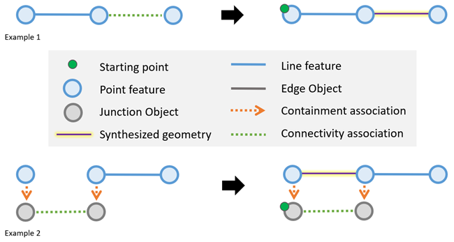

Synthesize association geometry in a trace
In scenarios in which you want to visualize the path of a trace through associations, the Trace and Add Trace Configuration tools can be used with the Synthesize Geometries parameter and Aggregated Geometry result type to infer and create geometry for traversed connectivity and structural attachment associations.
With the Synthesize Geometries parameter checked, geometry is synthesized as a straight line between the endpoints of the associations and displayed in the trace result stored in the Trace_Results_Aggregated_Line feature class. In cases in which an endpoint's container is nonspatial, endpoint locations are derived from the first spatial feature in the containment hierarchy.
The examples below demonstrate two scenarios in which association geometry can be synthesized between endpoints. In Example 1, on the left, you can see three point features (in blue) with the first two connected by a line and the second connected to the third through a connectivity association (green dashed line). On the right, when the trace is run from the starting point placed on the point feature, association geometry is synthesized between the association's endpoints and displayed in the aggregated geometry result (in highlighted purple). Looking at Example 2, on the left, you can see three point features (in blue). The first two are containers of junction objects (in gray) that participate in a connectivity association (green dashed line). On the right, when the trace is run from the starting point on the junction object, association geometry is synthesized between the association's endpoints using the location of the point feature containers and displayed in the aggregated geometry result (in highlighted purple).
Trace examples demonstrating how geometry is synthesized for a connectivity association between endpoints in the aggregated geometry result.

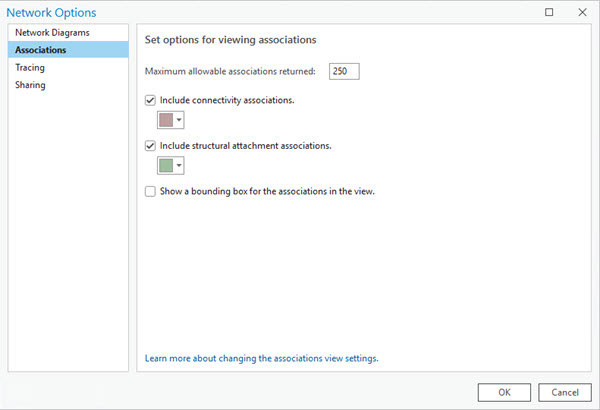

Association options
To change the options used by View Associations Mode, click the dialog box launcher on the Utility Network tab, at the bottom right of the Associations group. This opens the Network Options dialog box with the Associations tab active.
View Associations Options.
The following associations options are available:
  • Maximum allowable associations returned—The default is 250.
  • Include connectivity associations—This is enabled by default. Display connectivity associations with a dashed line when using View Associations Mode. The default color is a transparent gray-red. Use the color picker to change the color.
  • Include structural attachment associations—This is enabled by default. Display structural attachment associations with a dashed line when using View Associations Mode. The default color is a transparent gray-green. Use the color picker to change the color.
  • Show a bounding box for the associations in the view—This is disabled by default. A bounding box with a dashed line is created in the current map view extent when View Associations Mode is enabled. This represents the bounding box extent in which associations are displayed.
The Associations tab of the Network Options dialog box
Note:
When viewing the associations options while View Associations Mode is active, the Include connectivity associations and Include structural attachment associations options are disabled when set to false. These options cannot be switched to true on the Associations tab until you turn off View Associations Mode.
