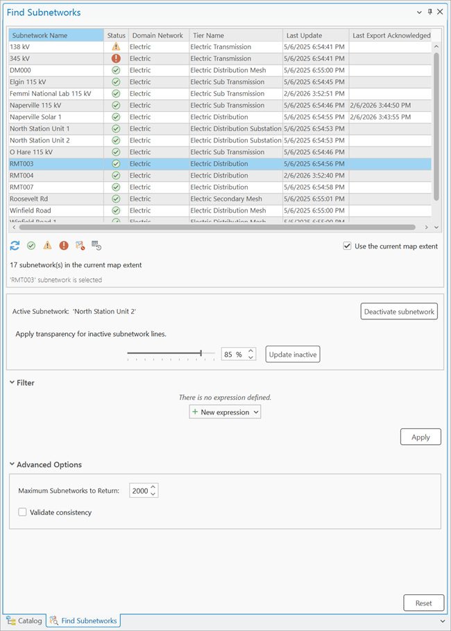

The Find Subnetworks pane allows you to locate and interact with subnetworks in your utility network. You can use the current extent to display subnetworks with geometry in the SubnetLine feature class, or return subnetworks from the Subnetworks table to perform various operations.
For example, you can perform subnetwork traces and update subnetworks using the context menu in the pane. You can also select the subnetwork controllers for a subnetwork, or activate a specific subnetwork so that it visually stands out in the map view. This can be helpful for clarity while editing, as it helps you distinguish paths in dense areas. It can also be used to draw focus to the subnetwork of interest in large-scale maps.
By default, the Find Subnetworks pane presents a list of all subnetworks with a record in the SubnetLine feature class which are present in the current extent of the map view. As you pan and zoom around the map, you can click the Refresh button Refresh found below the grid to filter the subnetworks using the new extent, or uncheck the Use the current map extent check box to return subnetwork records from the Subnetworks table. Quick filters below the grid and expressions in the Filter section of the pane can be used to further filter the list of subnetworks returned from the Subnetworks table.
You can right-click a subnetwork in the grid view to access a context menu of available operations. When a subnetwork has a record in the SubnetLine feature class with geometry, you can use the navigation and selection controls in the grid's context menu to Flash, Zoom To, Pan To, Select, or Pop-up information about the SubnetLine feature for the selected subnetwork. The grid view also presents information about a subnetwork such as the subnetwork status, the tier to which it belongs, when the last update subnetwork operation was run, and the last time the subnetwork was exported with acknowledgement.
In the grid view, the Status column indicates whether the subnetwork is clean, dirty or invalid.
  • A green check icon Clean indicates that the subnetwork is clean.
  • A yellow warning icon Dirty indicates that the subnetwork is dirty. This means that changes have been made to the subnetwork since the last time it was updated.
  • A red warning icon Invalid indicates that the subnetwork is invalid. This is displayed when either a subnetwork error is created or a validate consistency failure is encountered during the update operation.
The Find Subnetworks pane displaying subnetworks found in the current extent of the map
