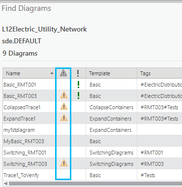

Diagram consistency warning icons next to diagram items in the Find Diagrams pane
There is a column in the Find Diagrams pane that reflects the Consistency field value stored in the database for each diagram.
Diagram consistency column in the Find Diagrams pane
This means the following:
  • If the diagram is flagged in the database as consistent, no icon appears in this column for the diagram.
  • If the diagram is flagged in the database as inconsistent—that is, inconsistent with the network topology space or its diagram template definition—an orange warning icon appears next to the diagram.
However, for diagrams that are inconsistent with the network editing space, no specific icon appears in the Find Diagrams pane. This means that a diagram that appears with no icon or with an orange warning icon in this pane may appear with a red warning icon in the Contents pane after you open it (see next section for more details).

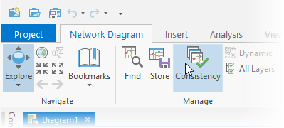

Diagram consistency for diagrams already open in ArcGIS Pro
Icons in the Contents pane for stored and temporary diagrams that are open in your ArcGIS Pro session may not reflect the current diagram consistency. For example, operations you or another user performed during the ArcGIS Pro session may have made the diagrams you opened inconsistent. However, at any time, you can force a diagram consistency check for all diagrams open in your project.
To check the current diagram consistency, click Consistency on the Network Diagram tab.
Consistency button on the Network Diagram tab
The consistency icons will be updated for all network diagrams currently open in your project .
