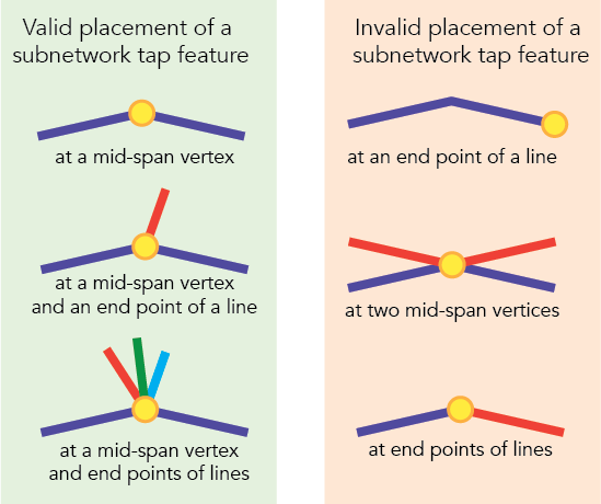

A tap must be coincident with only one midspan vertex. The midspan vertex can also be coincident with one or more endpoints from other line features or edge objects.

  • A tap feature is coincident with only endpoints.
  • A tap feature is coincident with multiple midspan vertices.
The following examples include valid and invalid placements of a subnetwork tap feature:
Subnetwork tap feature placement
