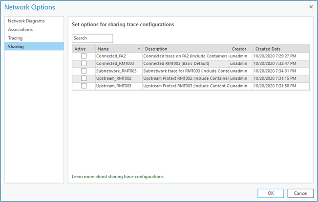

The Sharing pane of the Network Options dialog box is used to set named trace configurations as active for sharing. To access the Sharing tab, click the dialog box launcher on the Utility Network tab, to the lower right of the Tools group, and click the Sharing tab.
The Sharing tab lists all of the named trace configurations for the utility network in the current map.
Sharing tab of the Network Options dialog box
Optionally, check the Active check box next to a named trace configuration on the dialog box. This activates a configuration for sharing and includes it in the web map's map definition. Uncheck the option to deactivate a named trace configuration from sharing. This option is unchecked by default when new named trace configurations are added to the utility network.
