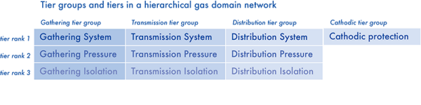

The following image shows an example diagram for tier groups and tiers in a hierarchical network:
Tier groups applied to a gas utility
A traditional gas domain network begins with tier groups that are created to represent gathering, transmission, distribution, and cathodic protection resources. Tiers are added to specific tier groups, shown here with a naming convention that combines the tier group and tier. For example, Gathering Isolation is a tier created within the gathering tier group. In the gas domain network, features can participate in one or several tiers (system, pressure, and isolation).

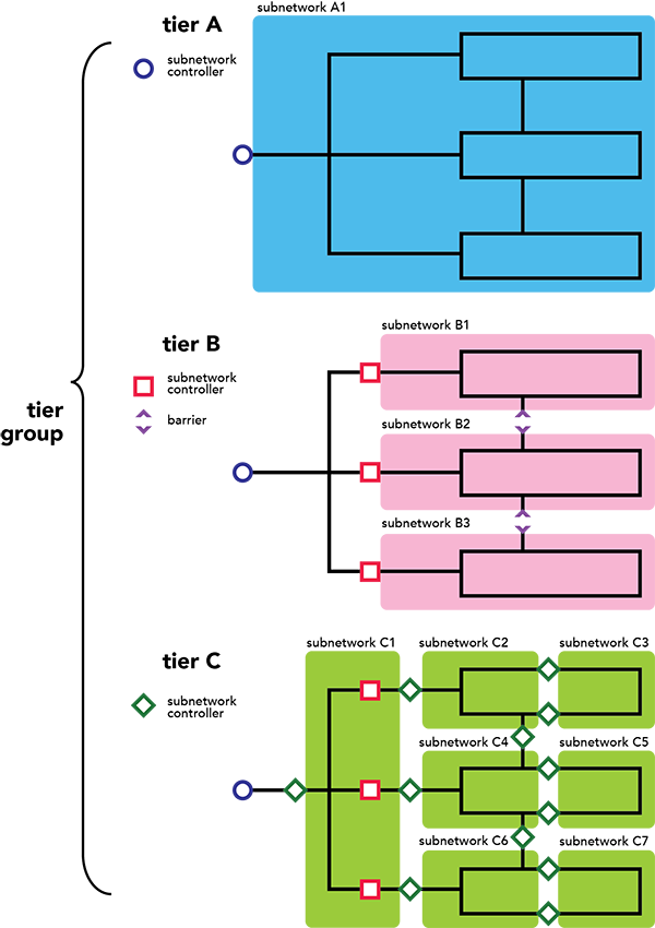

The following illustration shows how tiers in a tier group have overlapping definitions in a network diagram. The defining features of subnetwork extents in a tier are subnetwork controllers and barriers.
An instance of three tiers in a tier group
Tier groups allow you to model different types of subnetworks in a domain network. These three tier examples resemble zones in gas and water utilities called system, pressure, and isolation. Tier A is similar to a system zone with lines and devices connected to a common source such as a town-border station. Tier B is similar to a pressure tier in gas or water, defined by regulator stations and closed barriers. Tier C is similar to an isolation tier with zones that can be cut off with valves.
