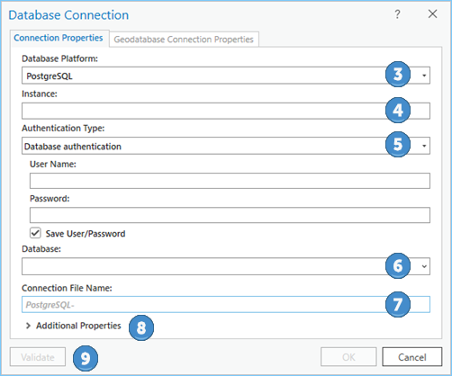

Follow the steps below to connect to a PostgreSQL database from the Database Connection dialog box in ArcGIS Pro.
Open the Catalog pane in ArcGIS Pro.
Right-click Databases or a folder under Folders and click New Database Connection.
Choose PostgreSQL from the Database Platform drop-down list.
In the Instance text box, provide the database cluster name or IP address of the server where PostgreSQL is installed.
The following are examples of information to include in the Instance text box:
If the PostgreSQL database cluster is on a server named ficus, type ficus in the Instance text box.
If the PostgreSQL database cluster is listening on a port other than the default (5432), include the port number in the instance. For example, if PostgreSQL is installed on a server named mamabear and is listening on port 49200, type mamabear,49200 in the Instance text box.
To use an IPV6 address to access the server where PostgreSQL is installed, type the address in brackets. For example, if the IPV6 address of the server is 1111:aa1:0:1:f111:a222:33f3:b4bb, type [1111:aa1:0:1:f111:a222:33f3:b4bb] in the Instance text box.
For an Amazon Aurora (PostgreSQL-compatible edition) or Amazon RDS for PostgreSQL instance, provide the instance name in the format
<database_instance_identifier>.<region_id>.rds.amazonaws.com. You provided the database instance identifier when you created the relational database service. The region ID is the AWS-assigned identifier of the AWS region where the instance is running. For example, if you created the instance with the identifier mypgrdsdb in the us-east-1 Amazon Web Services region, type mypgrdsdb.us-east-1.rds.amazonaws.com in the Instance text box.For a Google Cloud SQL for PostgreSQL instance, provide the public IP address of the instance in the Instance text box.
For a Microsoft Azure Cosmos DB for PostgreSQL instance, the connection string is in the format
c.<cluster_name>.postgres.database.azure.com. For example, you named the cluster allmydata when you created it, type c.allmydata.postgres.database.azure.com in the Instance text box.For a Microsoft Azure Database for PostgreSQL instance, the instance name is in the format
<server_name>.postgres.database.azure.com. For example, you named the server spatialdata when you created it, type spatialdata.postgres.database.azure.com in the Instance text box.
Note:
If the PostgreSQL database cluster is listening on a port other than the default (5432), you can include the port number in the instance. For example, if PostgreSQL is installed on server
mamabearand is listening on port 49200, type mamabear,49200 in the Instance text box. Alternatively, provide the port number as an additional property (see step 8 below).Choose the type of authentication to use when connecting to the database: Database authentication or Operating system authentication.
If you choose Operating system authentication, you do not need to provide a username and password—the connection is made using the Security Support Provider Interface (SSPI), Lightweight Directory Access Protocol (LDAP), or Generic Security Service Application Program Interface (GSSAPI) login name and password used to sign in to the operating system. If the login used for the operating system is not mapped to a valid database login, the connection fails.
If you choose Database authentication, you must provide a valid username and password in the User name and Password text boxes, respectively.
Uncheck Save user name and password if you prefer not to save your login information as part of the connection; doing this can help maintain the security of the database. However, if you do this, you will be prompted to provide a username and password every time you connect.
Note:
Save user name and password must be checked for connection files that use database authentication to provide ArcGIS web services with access to the database, or if you want to search ArcGIS Pro to locate data accessed through this connection file.
Type or choose the name of the database on the PostgreSQL database cluster to which you want to connect.
Provide a name for the connection file in the Connection File Name field.
A default name is created based on the connection property values. You can use the default, or provide a more descriptive file name.
This is the name that will appear in the Catalog pane and view, and the name of the
.sdefile stored on disk.If the PostgreSQL database cluster communicates over a nondefault port, expand the Additional Properties section, choose Port from the Property drop-down menu, and provide the port in the Value field.
Click Validate to confirm that the connection information is valid and the database is accessible.
If the database contains a geodatabase and the connection is valid, the Geodatabase Properties tab is now active. If necessary, you can alter geodatabase connection properties to connect to a traditional version other than the default version, configure the connection as a branch version connection, or connect to a historical moment.
Click OK to create the connection file.
A database connection appears under Databases in the Catalog pane, and a connection file (.sde) is created in the ArcGIS Pro project directory.
