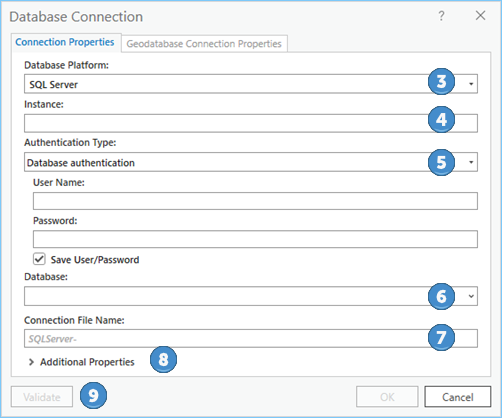

Follow the steps below to connect to a SQL Server database from the Database Connection dialog box in ArcGIS Pro.
The Database Connection dialog box
  1. Open the Catalog pane in ArcGIS Pro.
  2. Right-click Databases or a folder under Folders and click New Database Connection.
  3. Choose SQL Server from the Database Platform drop-down list.
  4. Provide the SQL Server instance name in the Instance text box.
    Examples include the following:
    • For a SQL Server named instance of terra\gis, type terra\gis in the Instance text box.
    • If you use a default SQL Server instance, you can specify the instance name or the IP address of the server in the Instance text box. If specifying an IPV6 address, enclose the address in brackets. For example, if the IPV6 address of the server is 2000:ab1:0:2:f333:c432:55f6:d7zz, type [2000:ab1:0:2:f333:c432:55f6:d7zz] in the Instance text box.
    • If the SQL Server database is listening on a port other than the default (1433), you can include the port number in the instance. For example, if the SQL Server instance is named basset\spatial and is listening on port 61000, type basset\spatial,61000 in the Instance text box. Alternatively, you can provide the port number using the Port property. (See step 8 below.)
    • For an Amazon RDS for SQL Server instance, the instance will be in the format <database_instance_identifier>.<region_id>.rds.amazonaws.com. You provided the database instance identifier when you created the relational database service. The region ID is the AWS-assigned identifier of the AWS region where the instance is running.
    • For a Google Cloud SQL for SQL Server instance, provide the public IP address of the instance in the Instance text box.
    • For a Microsoft Azure SQL Managed Instance or Microsoft Azure SQL Database instance, provide the server name in the Instance text box. For example, if the server name is cloudy4u.dbid123.database.windows.net, type cloudy4u.dbid123.database.windows.net in the Instance text box.
    If your SQL Server instance uses failover clusters, you can add conditions to the instance string to take advantage of the redundant instance.
    You can append additional conditions to the instance name to request encrypted connections to the SQL Server instance.
  5. Choose the type of authentication to use when connecting to the database.
    The Microsoft Entra ID options are supported only when connecting to Azure SQL Database or Azure SQL Managed Instance.
    • Operating system authentication—You do not need to provide a username and password; the connection is made using the login name and password used to sign in to the operating system. If the login used for the operating system is not a valid database login, the connection fails.
    • Database authentication—You must provide a valid database username and password in the User name and Password text boxes, respectively.
    • Microsoft Entra MFA—You must provide the Entra ID username but not the password. When you connect, a code is sent to you in a text message, email, or MFA device, or it can use a fingerprint scan for authentication. This second part of the authentication process varies depending on how your network and authentication protocols are configured.
      You cannot register a database connection that uses Microsoft Entra MFA with an ArcGIS Server site.
    • Microsoft Entra Password—You must provide a valid Entra ID username and password in the User name and Password text boxes, respectively.
    • Microsoft Entra Integrated—You do not need to provide a username and password; the connection is made using the login name and password used to sign in to the operating system. If the login used for the operating system is not a valid Entra ID login, the connection fails.
    Note:
    • Save user name and password must be checked for connection files that use database authentication or Entra Password authentication to provide ArcGIS web services with access to the database, or if you need to search ArcGIS Pro to locate data accessed through this connection file.
    • Outside of ArcGIS, you can create usernames in SQL Server that contain special characters. These usernames must be delimited whenever they are used. ArcGIS will add the delimiter automatically when it is passed to SQL Server; you do not need to include delimiters with the username. For example, if your username is map.user, type map.user, not "map.user", in the User name text box. For more information on regular and delimited identifiers, see the SQL Server documentation.
  6. In the Database text box, choose the name of the database you want to connect to on the instance.
    Note:
    When you use a contained database user model or you connect to Microsoft Azure SQL Database as any user other than the database administrator, you must type the name of the database in the Database text box.
  7. Provide a name for the connection file in the Connection File Name field.
    A default name is created based on the connection property values. You can use the default, or provide a more descriptive file name.
    This is the name that will appear in the Catalog pane and view, and the name of the .sde file stored on disk.
  8. Optionally, expand the Additional Properties section and specify parameters to connect that are in addition to those required in the previous steps.
    • Port—If the SQL Server instance communicates over a nondefault port, choose this parameter from the Property drop-down menu and provide the correct port in the Value field.
    • Encrypt—Enables SSL encryption on the connection. Supported values are Yes or No.
    • TrustServerCertificate—Allows encryption without need for a client certificate. Supported values are Yes or No.
    • ApplicationIntent—Supports read-only routing if the user is connecting to the AlwaysOn availability group listener and read-only routing has been configured. Supported values are READONLY or READWRITE.
    • MultisubnetFailover—Enables faster failover for all Availability Groups and failover cluster instances in SQL Server and will significantly reduce failover time for single and multisubnet Always On topologies. Supported values are Yes or No.
  9. Click Validate to confirm that the connection information is valid and the database is accessible.
    If the database contains a geodatabase and the connection is valid, the Geodatabase Properties tab is now active. If necessary, you can alter geodatabase connection properties to connect to a traditional version other than the default version, configure the connection as a branch version connection, or connect to a historical moment.
  10. Click OK to create the connection file.
A database connection appears under Databases in the Catalog pane, and a connection file (.sde) is created in the ArcGIS Pro project directory.
