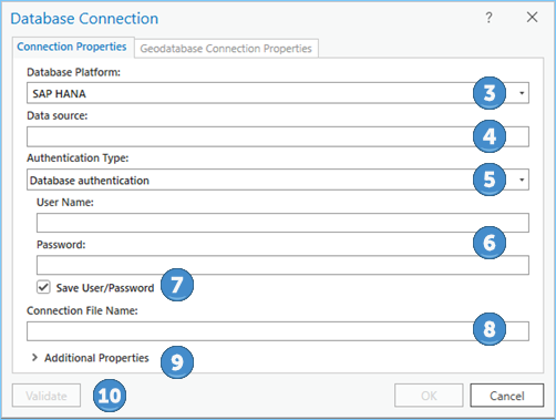

Follow the steps below to connect to SAP HANA using the Database Connection dialog box.
The Database Connection dialog box
  1. Open the Catalog pane in ArcGIS Pro.
  2. Right-click Databases or a folder under Folders and click New Database Connection.
  3. Choose SAP HANA from the Database Platform drop-down list.
  4. In the Data source text box, type one of the following:
    • The SAP HANA server name and the SQL port number used to communicate with the database separated by a colon (:). For example, if the fully qualified name of your SAP HANA server is myserver.network.com and SAP HANA communicates through port 98765, type myserver.network.com:98765. Alternatively, you can set a port number under Additional Properties. (See step 9 below.)
    • The data source name you configured for the ODBC driver.
  5. Use database authentication for the authentication type.
    Operating system authentication is not supported.
  6. Provide a valid database username and password in the User name and Password text boxes, respectively.
  7. If you prefer not to save your login information as part of the connection, uncheck Save user name and password.
    Doing this can help maintain the security of the database. However, if you do this, you will be prompted to provide a username and password every time you connect from ArcGIS Pro.
    Note:
    Save user name and password must be checked for connection files that you register with an ArcGIS Server site or if you want to search to locate data accessed through this connection file.
  8. Provide a name for the connection file in the Connection File Name field.
    A default name is created based on the connection property values. You can use the default, or provide a more descriptive file name.
    This is the name that will appear in the Catalog pane and view, and the name of the .sde file stored on disk.
  9. Optionally, expand the Additional Properties section to type a connection parameter and value.
    Read the SAP HANA documentation for information about additional and optional connection parameters.
  10. Click Validate to confirm that the connection information is valid and the database is accessible.
    If the database contains a geodatabase and the connection is valid, the Geodatabase Properties tab is now active.
  11. Click OK to create the connection file.
A database connection appears under Databases in the Catalog pane, and a connection file (.sde) is created in the ArcGIS Pro project directory.
