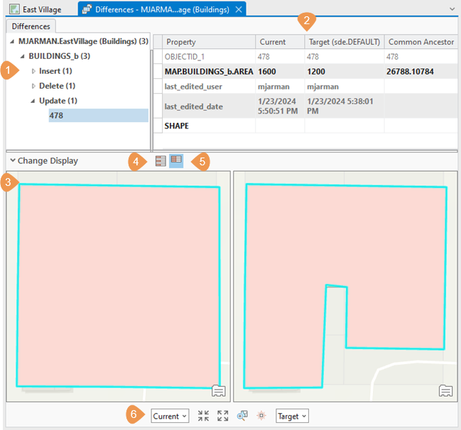

Use the Differences view
When the Differences view is opened for a web feature layer that is accessing a named version, the Differences tab displays differences between the current named version and the default version. Differences between versions are symbolized using bold text.
Differences view
Element
Description
Differences list—The differences list section contains all layers and features that have differences.
Information grid—The information grid section shows the attributes and values for all representations of the feature that you select from the differences list. Attribute values displayed in bold signify that edits made in the current version contain differences. Attribute values that are bold and unavailable refer to system maintained fields that contain differences.
Change Display viewer—The difference display viewer is an expandable section at the bottom of the Differences view. By displaying the selected feature on maps in the viewer, you can compare edits made to the feature's geometry and visualize the conflict between the two versions. You can also navigate the maps in the viewer independently and identify features in the display.
Show All Show All fields —Displays all the fields for the feature.
5
Show Differences Show only fields in conflict —Displays only those fields that have differences.
6
Change Display navigation tools—The following tools allow you to navigate and control the version displayed and navigate in the change display windows:
  • Two drop-down menus, one for each display window, allow you to change the display to show the Current (named version), Target (default version), or Common Ancestor representation for the selected feature.
  • Zoom In Fixed Zoom In—Zooms in to show the map at a larger scale, which increases the size of the features but shows less area.
  • Zoom Out Fixed Zoom Out—Zooms out to show the map at a smaller scale, which decreases the size of the features but shows more area.
  • Zoom To Selected Zoom To Results—Zoom the map to center on the selected feature.
  • Flash Selected Flash—The selected feature will briefly flash in blue and change to red in the Change Display viewer.
