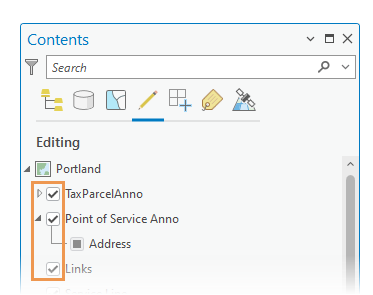

  1. Click the ribbon View tab. In the Windows group, click Contents .
    The Contents pane appears.
  2. Click the List By Editing tab .
  3. Check or uncheck a layer check box.
    Contents pane
    Checked
    Enable editability.
    Unchecked
    Disable editability.
    To enable editability for only one layer and disable it for all other layers, right-click the layer, and click Make this the only editable layer .
