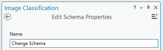

In the Image Classification pane, right-click New Schema and click Edit Properties.
Type a name for the schema in the Name text box.
Click Save.

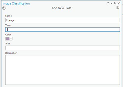

Add a new class to the schema.
Right-click the schema you created, and choose Add New Class.
Type a name for the class in the Name text box.
Provide a value for the class.
The value cannot be 0.
Optionally, choose a color for the class.
Click OK.
The class is added to the schema in the Image Classification pane.

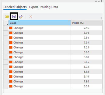

The polygons can overlap; however, if you are not sure about an object, do not include it in the training samples. A new record is added in the Labeled Objects group of the Image Classification pane.
Repeat steps 3a through 3c to create training samples for each class in the schema.
It is recommended that you collect a statistically significant number of training samples to represent each class in the schema.
When you finish creating training samples, click Save in the Image Classification pane.
In the Save current training sample window, browse to the geodatabase.
Provide a name for the feature class, and click Save.

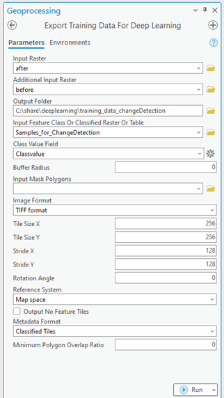

Open the Export Training Data For Deep Learning tool so you can export the training samples as image chips.
An image chip is a small image that contains one or more objects to be detected. The image chips are used to train the deep learning model.
Provide the Input Raster value.
Generally, this is the earliest image before any changes.
Provide the Additional Input Raster value.
Generally, this is the latest image after the changes.
Provide the Input Feature Class Or Classified Raster Or Table value.
This is the labeled objects' training samples file that you created.
Provide the Class Value Field value.
This is the specified label feature class for the changes. The feature class contains a field named
ClassValue, which you can use.Provide the Output Folder value.
This is the path and name of the folder where the output image chips and metadata will be stored.
Optionally, specify a value for the Meta Data Format parameter.
The metadata format that is best for change detection is Classified Tiles.
Click Run to export the training data.

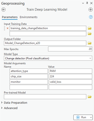

Open the Train Deep Learning Model tool.
For the Input Training Data parameter, browse to and select the training data folder where the image chips are stored.
For the Output Model parameter, provide the file path and name of the folder where the output model will be saved after training.
Optionally, specify a value for the Max Epochs parameter.
An epoch is a full cycle through the training dataset. During each epoch, the training dataset you stored in the image chips folder is passed forward and backward through the neural network one time. Generally, 20 to 50 epochs are used for initial review. The default value is 20. If the model can be further improved, you can retrain it using the same tool.
Optionally, change the Model Type value in the drop-down list.
The model type determines the deep learning algorithm and neural network that you will use to train the model, such as the Change Detector architecture. For more information about models, see Deep learning models in ArcGIS. For documentation examples, supported metadata, and model architecture details, see Deep learning model architectures.

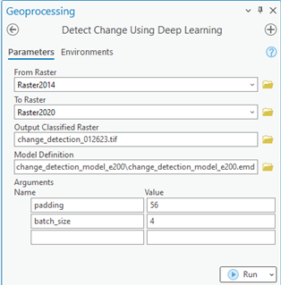

Open the Detect Change Using Deep Learning tool.
For the From Raster parameter, browse to and provide the image from time period one—the reference image.
For the To Raster parameter, browse to and provide the image from time period two—the more current image.
For the Output Classified Raster parameter, type the name for the output raster.
The output classified raster will contain pixel values of 0 and 1 in which 0 means no change, and 1 means change.
The Arguments parameter is populated from the information from the Model Definition value. These arguments vary, depending on the model architecture. In this example, the Change Detector model architecture is used, so the padding and batch_size arguments are populated.
Accept the default values for the Arguments parameter or edit them.
padding—The number of pixels at the border of image tiles from which predictions are blended for adjacent tiles. Increase the value to smooth the output, which reduces artifacts. The maximum value of the padding can be half the tile size value.batch_size—The number of image tiles processed in each step of the model inference. This value depends on the memory size of the graphics card.
Click Run to start the inferencing.
