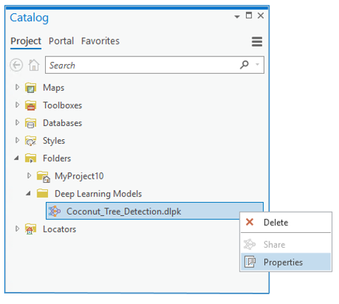

Deep learning model package
A deep learning model package Deep Learning Model Package (.dlpk) contains the files and data required to run deep learning inferencing tools for object detection or image classification. The package can be uploaded to your portal as a DLPK item and used as the input to deep learning raster analysis tools.
Deep learning model packages must contain an Esri model definition file (.emd) and a trained model file. The trained model file extension depends on the framework you used to train the model. Depending on the model framework and options you used to train the model, you may need to include a Python raster function (.py) or additional files. You can include multiple trained model files in a single deep learning model package.
You can open most packages in any version of ArcGIS Pro. By default, the contents of a package are stored in the <User Documents>\ArcGIS\Packages folder. You can change this location in the Share and download options. If the ArcGIS Pro version used to open a package does not support the functionality in the package, the functionality will not be available.
To view or edit the properties of a .dlpk package, or to add or remove files from a .dlpk package, right-click the .dlpk package in the Catalog pane and click Properties.

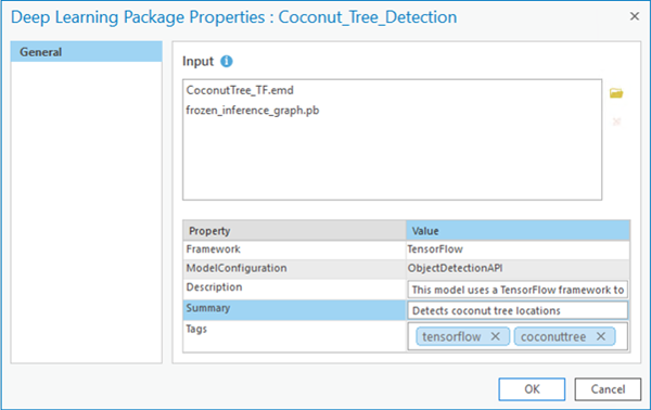

Open a deep learning package in the Catalog pane.
Properties include the following information:
  • Input—The .emd file, trained model file, and any additional files that may be required to run the inferencing tools.
  • Framework—The deep learning framework used to train the model.
  • ModelConfiguration—The type of model training performed (object detection, pixel classification, or feature classification).
  • Description—A description of the model. This is optional and editable.
  • Summary—A brief summary of the model. This is optional and editable.
  • Tags—Any tags used to identify the package. This is useful for .dlpk package items stored on your portal.
Deep learning package properties
Any property that is edited in the Properties window is updated when you click OK. If the .dlpk package item is being accessed from your portal in the Catalog pane, the portal item is updated.
