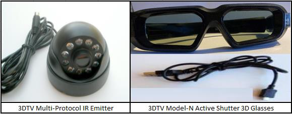

  • 3DTV Corp Generation 2 (Gen 2) multi-protocol IR emitter
  • 3DTV Corp Model-N 3D glasses
Before starting the steps below, charge the 3DTV 3D Model-N glasses using the USB cable that's included with the glasses.

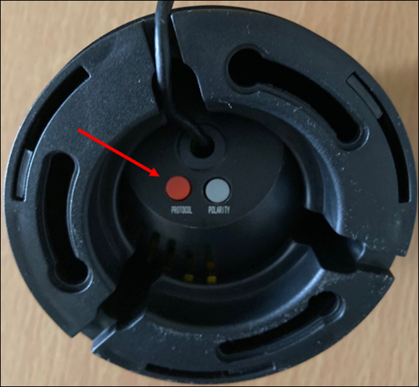

  5. Press the Protocol button on the underside of the emitter once to change the LED color from red to orange.
    This synchronizes the emitter with the Model-N 3D glasses.
