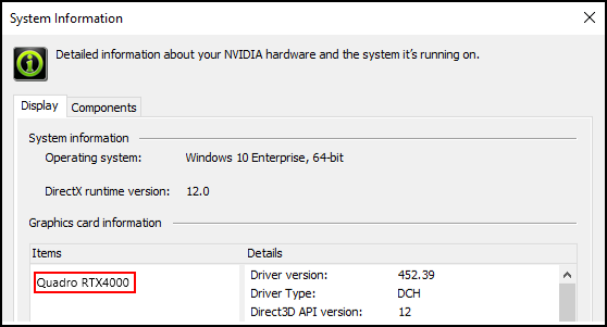

  2. At the bottom of the NVIDIA Control Panel dialog box, click System Information.
    The System Information dialog box appears that displays the graphics card type and version.
  3. Make note of the information in the System Information dialog box.

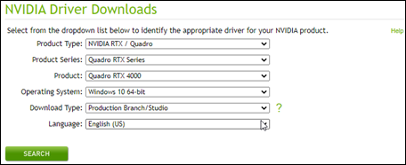

  1. Open a web browser, and go to the NVIDIA download driver site.
  2. For Product Type, click the drop-down list and select the graphics card identified in the System Information dialog box.
  3. For Product Series, select the appropriate option identified in the System Information dialog box.
  4. For Product, select the graphics card used by your computer.
  5. For Operating System, choose Windows 10 64-bit.
    NVIDIA Drive Downloads settings
  6. Click Search.
  7. Download the driver identified from the search, and save it to a known location on disk.

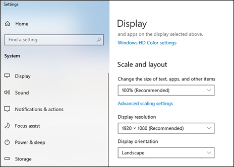

  1. Right-click your desktop and select Display settings.
    The Display settings window appears.
  2. In the Scale and layout section, for Display resolution, select 1920 x 1080 (Recommended) from the drop-down list.
    Stereo monitor settings
  3. In the Multiple displays section, ensure that Extend these displays is selected from the drop-down menu.

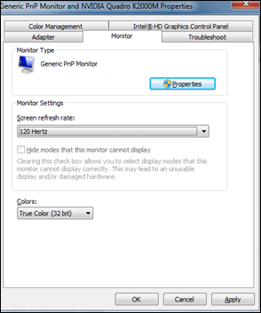

  9. Click the Monitor tab.
    Monitor tab
  10. In the Monitor Settings section, for Screen refresh rate, select 120 Hertz from the drop-down menu, and click OK to save the settings.
  11. Click OK to close the display properties window.

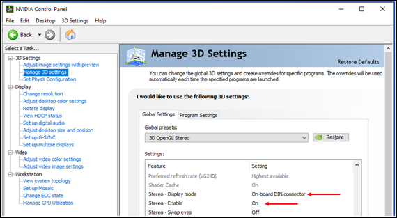

  1. Right-click your desktop and select NVIDIA Control Panel.
    The NVIDIA Control Panel window appears.
  2. In the 3D Settings category, select Manage 3D settings.
    The Manage 3D Settings panel opens.
  3. Under I would like to use the following 3D settings, click the Global Settings tab.
  4. For Global presets, select 3D OpenGL Stereo from the drop-down list.
  5. Ensure that Stereo - Display mode is set to On-board DIN connector and Stereo - Enable is set to On.
    NVIDIA Control Panel settings
The computer stereo configuration is now complete.
