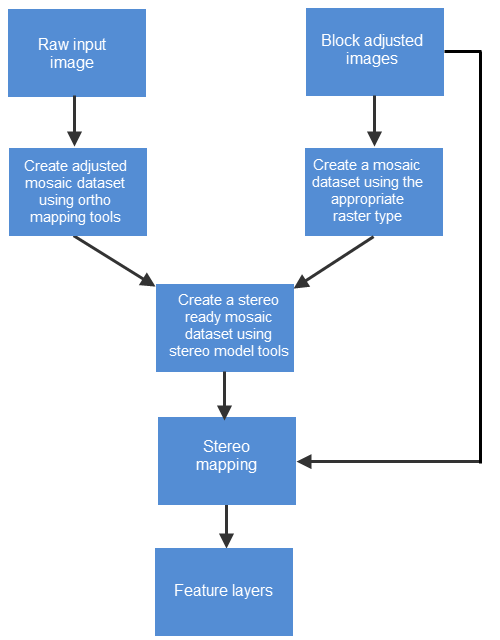

Recommended stereo mapping workflow
If the images have been geometrically adjusted, you can prepare the input by creating a mosaic dataset and adding the images using the appropriate raster type. Then build the stereo model using the Build Stereo Model tool. Stereo viewing relies on pyramids and statistics; it's recommended that you calculate statistics and build pyramids with bilinear interpolation for the images.
Note:
For ADS data, the stereo map can display L1 images directly without additional adjustment.
You can also quickly define a stereo image source using two separate images—a left and a right image—such as a stereo pair provided by satellite data distributers. If you use a stereo pair, ensure that the image pair has the geometric accuracy required for the feature collection. For practical application and better stereo display, use a mosaic dataset to manage the stereo models, because satellite data and ADS data both need an elevation for projection metric fitting. With a mosaic dataset, you can define the elevation through the geometric function.

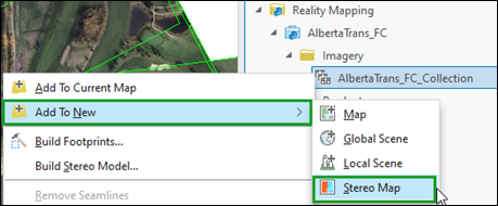

    Alternatively, a stereo model collection can be added to the stereo window by right-clicking on the mosaic dataset in the Catalog pane, selecting Add to New > Stereo Map.
    Add a stereo collection to a Stereo Map
    You can also drag and drop a mosaic dataset from the Catalog pane into the Stereo Map.
