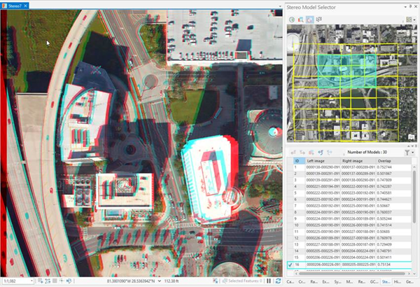

Stereo Map view with Stereo Model Selector pane
The Stereo Map view with anaglyph stereo pair and Stereo Model Selector pane are shown.
A stereo map has a projection that is defined by the current stereo model. The spatial reference of the map cannot be changed, but the stereo map can display the supported layer in any projection. If the layers have a different coordinate system than the stereo map, they are projected on the fly to the spatial reference of the stereo map. The best practice is to avoid reprojection when possible.
When a stereo pair is loaded, the Stereo Map view displays two images in which the epipolar lines are parallel to the x-axis. The stereo cursor always returns to x, y, and z, which are displayed in the stereo view status in current projection units. If no vertical datum is defined, the z-unit will be the same as that defined in the mosaic dataset.

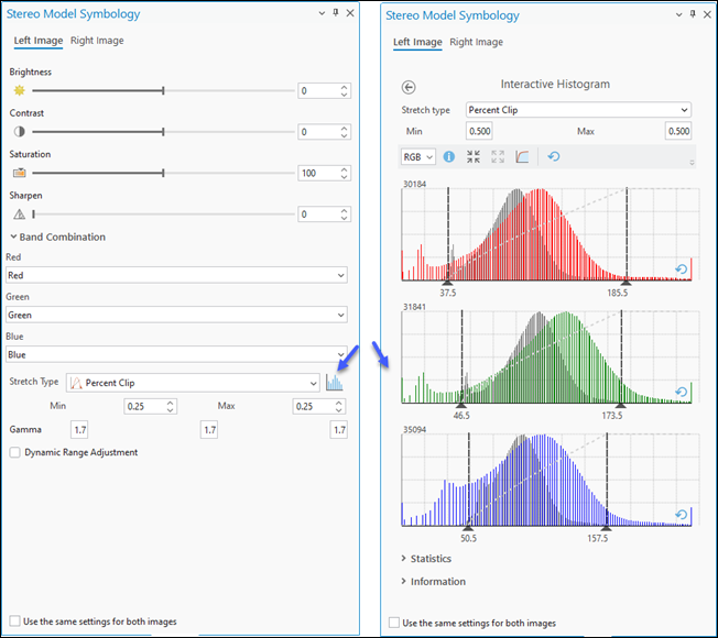

Stretch opens the Stereo Model Symbology pane, allowing you to adjust the image display setting for both images. You can adjust the brightness, contrast, gamma, saturation, and sharpness for each band of each image. Additionally, you can adjust symbology settings such as band combination, stretch type, histogram for each band, and dynamic range adjustment. If the settings for both images are the same, you can check the Use same settings for both images check box and make the display adjustments to both images simultaneously.
Stereo model symbology

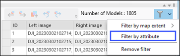

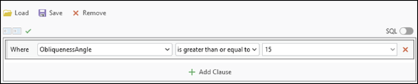

Click the Ignore Oblique tool to filter out stereo pairs with oblique angles greater than 15 degrees. This tool is particularly useful when performing feature extraction from a block of images comprised of nadir and oblique images. Ignore Oblique can also be activated from the Filter option in the Stereo Model Selector pane using the Filter by attribute option.
Stereo model Filter by attribute option
Filter by attribute query
The number of models visible in the Stereo Model Selector pane after activating the Ignore Oblique filter will be equal to the filtered result. While activated, both the Auto Load best pair and Next Stereo Model options honor the filtered results. Clicking Ignore Oblique again will deactivate it.

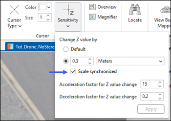

The cursor sensitivity page allows you to determine how much the z-value changes per scroll of the mouse wheel. The default value is the value set by the system based on data characteristics. The Scale synchronized option allows you to automatically align the z-value rate of change with the Stereo Map viewing scale. Once the z-value rate of change is set and the Scale synchronized option is checked, the z-rate of change will be automatically adjusted based on subsequent viewing scale values. For example, if, at a scale of 1:100, the z-rate of change is set to 30 centimeters (0.3), when the viewing scale is changed to 1:1000, the scroll wheel z-rate of change will be adjusted to 3 meters. This option is unchecked by default and can also be set on the 3D Input Device tab on the Options dialog box. It also allows you to set how the accelerator (press the Shift key) and decelerator (press the Caps Lock key) shortcuts will affect the change in z-value per scroll.
Stereo Z sensitivity options
You can change the application default values for cursor sensitivity on the Navigation Options page.
