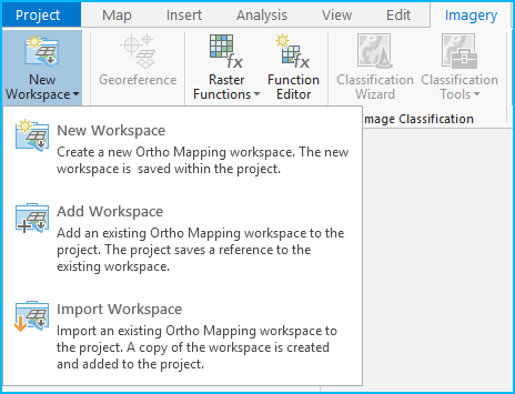

Create an ortho mapping workspace
You can create an ortho mapping workspace from drone imagery, satellite imagery (with a Rational Polynomial Coefficient [RPC] camera model), digital aerial imagery, scanned aerial photography, or an existing mosaic dataset. The type of ortho mapping workspace defines the methods and algorithms that are used to process the image type. Choose the appropriate type when you create an ortho mapping workspace for your data. The New Ortho Mapping Workspace wizard on the Imagery tab allows you to create an ortho mapping workspace from a collection of images or an existing mosaic dataset, and it also allows you to import or add from an existing ortho mapping workspace.
New Workspace button on the Imagery tab
The wizard guides you through the process of creating an ortho mapping workspace, in which you enter information to define your project, such as name, description, and workspace type, Ortho Mapping in this case. Depending on the Sensor Data Type setting of the workspace—for example, drone or satellite—the wizard pane presents appropriate options such as location of your source image collection, camera, or sensor model files, and spatial reference system.
