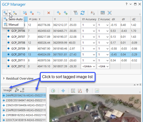

GCP Manager
The GCP Manager pane is used to add, edit, and manage the control points so they can be used in the ortho mapping project. If the GCP Manager pane does not have any rows in the table, it means that there are currently no GCPs or tie points associated with the ortho mapping project. If you already have GCPs saved in a file, you can import them using the Import GCPs button . If you do not have a GCP file, you can create GCPs using Compute GCPs on the Manage GCPs drop-down menu. You can also create GCPs and tie points using the Semi_Auto GCP button , or the Manual GCP button .
Besides importing, GCPs can be added manually to the GCP Manager pane by clicking the Add GCP Manually button . Once selected, a new row will be added to the GCP Manager table. The GCP ID, X, Y, and Z fields can be edited or updated with the respective coordinate information. The XY Accuracy or Z Accuracy field can be used to classify a GCP as a 1D, 2D, or 3D point. Use the following as a guide when reclassifying a GCP:
  • One dimensional (1D) GCP—A GCP having only a vertical or z-value. The XY Accuracy field for this GCP type must be set to NA and have only a height or z-value entered in the Z field.
  • Two dimensional (2D) GCP—A GCP having x,y values (easting and northing) only. The Z Accuracy field for this GCP type must be set to NA, and have x,y values entered in the appropriate fields.
  • Three dimensional (3D) GCP—A GCP having a x,y and z-values (easting, northing, and height).
    Note:
    Double-click in each field to enter 3D values in the GCP Manager. To convert a 3D GCP to a 1D or 2D GCP, set the XY Accuracy or Z Accuracy fields to NA.
GCP Manager with 1D, 2D, and 3D GCPs
GCP Manager with 1D, 2D, and 3D GCPs is shown.
Once 2D or 3D GCP coordinates are entered in the GCP Manager table using the Add GCPs Manually button , a pending GCP symbol will be displayed in the 2D map view highlighting the GCP location. The accuracy of the displayed GCP location will be directly related to the accuracy of the map. It is recommended that a surveyor-supplied description or image showing the GCP location be used to guide point identification and measurement. 1D GCPs that do not have x,y values will not be displayed on the map.

To temporarily disable a GCP, change the XY Accuracy and Z Accuracy fields to <NA>.
To change a GCP into a check point, right-click the GCP row in the table, and choose Change to Check Point.
Tagging and Sorting GCP’s
Selecting the first GCP in the GCP Manager results in a list of overlapping images being listed in the image Preview section. Manually locating and tagging the GCP in the first image in the list will result in the auto-tagging of the same GCP in corresponding images using image correlation.
Note:
While GCP autocorrelation works with the tagging of GCPs on a single image using Semi-Auto , it is recommended that a minimum of two images be manually tagged before using Semi-Auto to tag a third image.
In cases where all images were not tagged during the autocorrelation process, manually tagging an untagged image would result in another attempt to autocorrelate the outstanding images.
Once the images have been tagged, single clicking Image on the image list menu bar will sort the image list by a quality score, in lowest to highest order. Single clicking Image a second time will reverse the sorting order.
GCP Manager, reorder list
